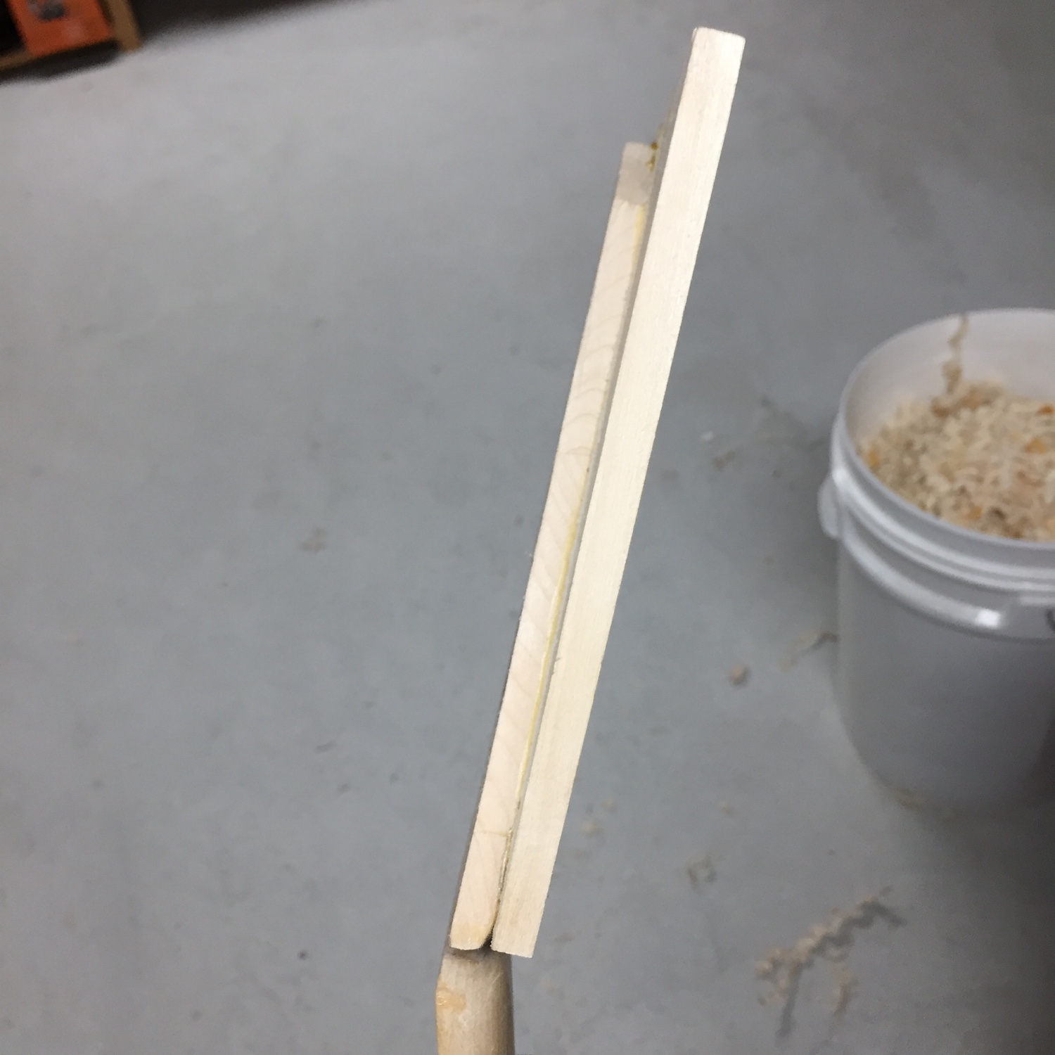

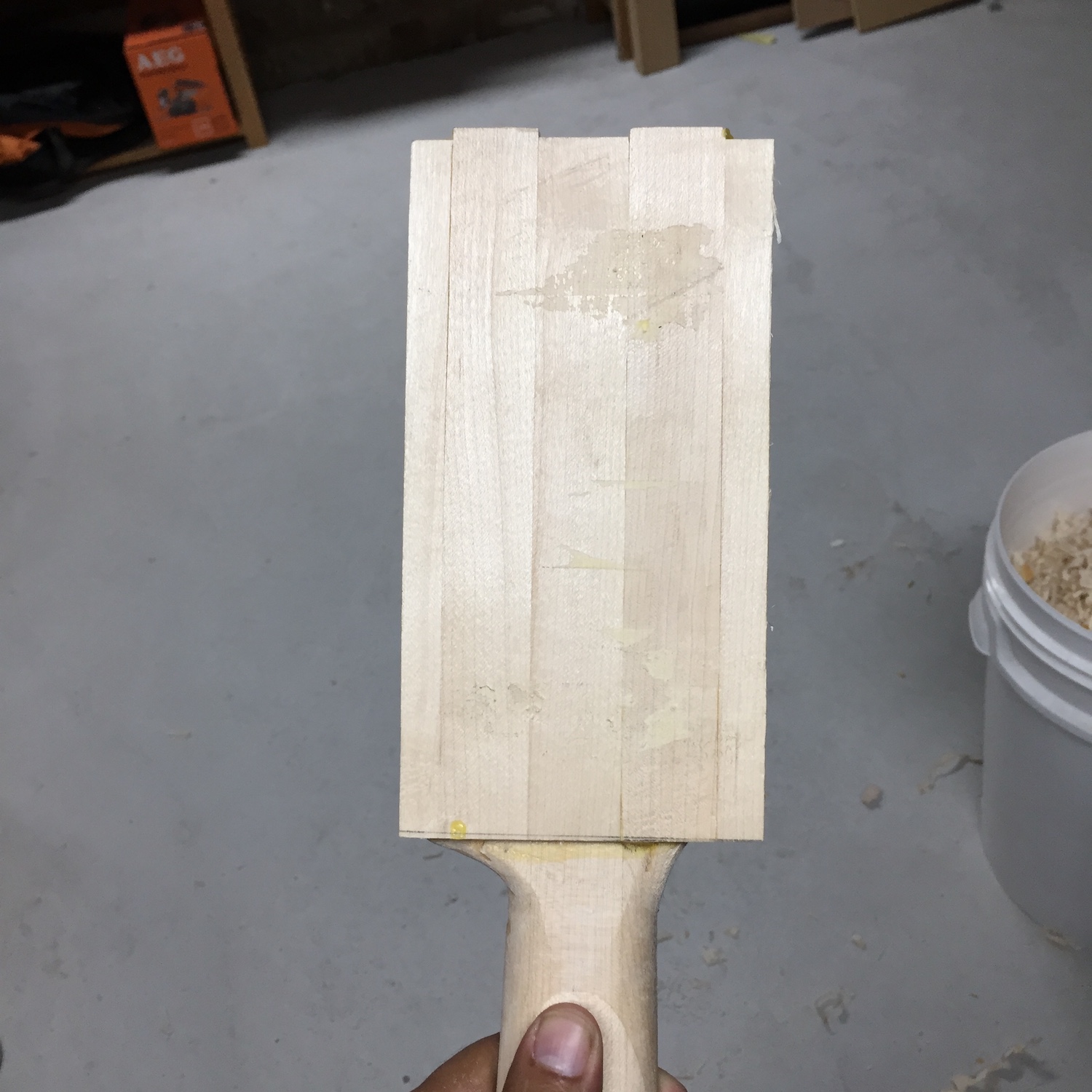

    Okay, so after some ruminating and some cursing, i elected to try and salvage this by doing as Tony had suggested and thinning the headstock further and then adding a patch.
    Which ended up looking like this:

    I left this for a couple of days to settle before attempting to re-shape it (next post)

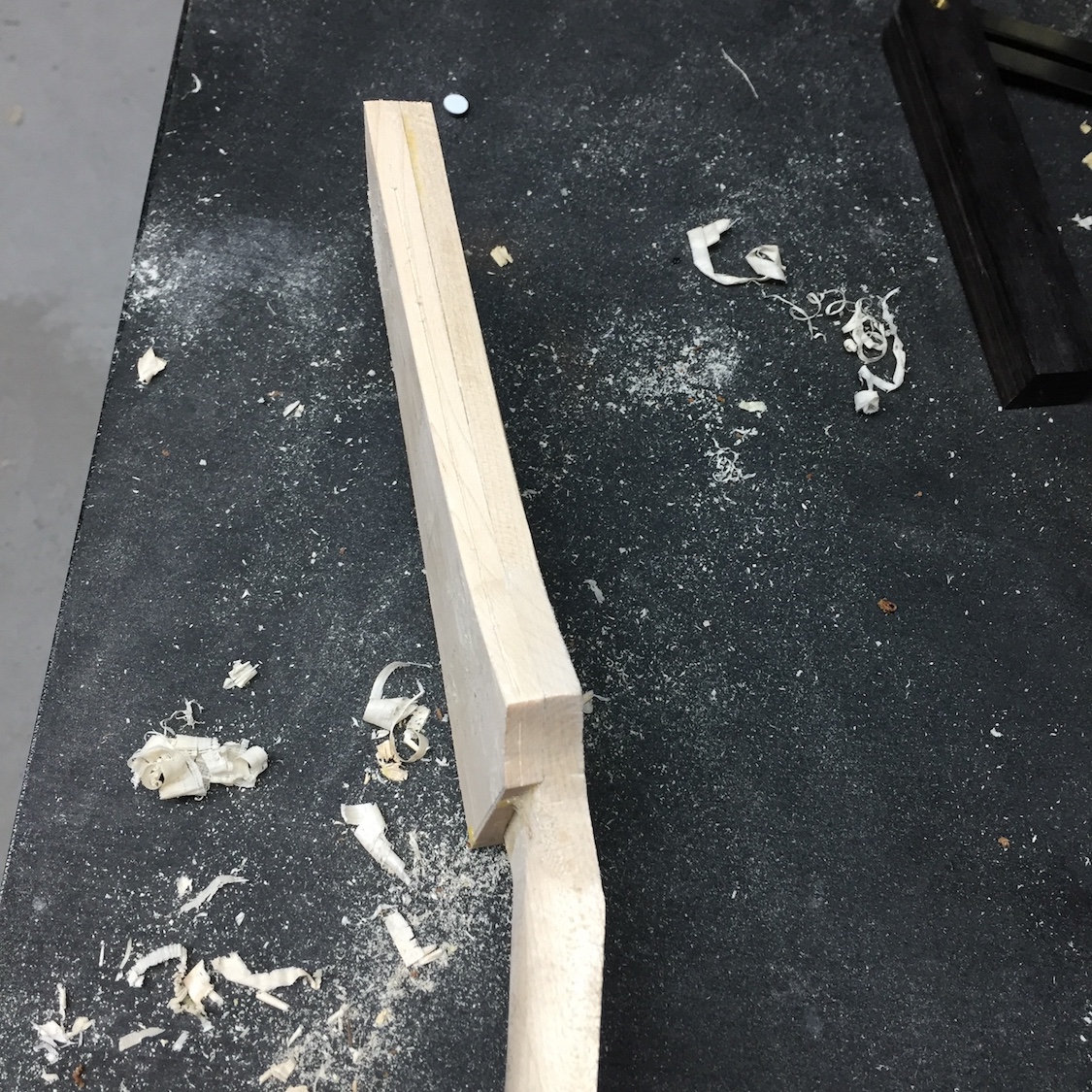

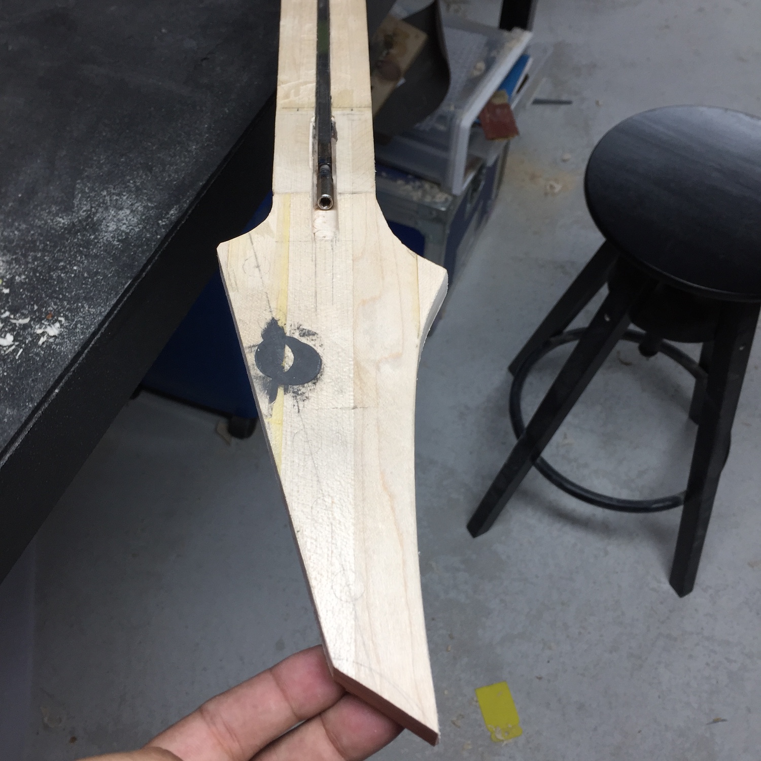

    A combination of japanese razor saws and a spokeshave and rasps got me back to this:
ID:	16300 Click image for larger version.
ID:	16301 Click image for larger version.
    there is still about 3/16" to come off of the thickness, which i will be doing with a router jig set up.
    I also discovered that its not such a great idea to have your truss rod channel routed until you've actually got the truss rod you are going to use in your hot little hand!
ID:	16303 Click image for larger version.
    I cut my TR channel with a 1/4" bit which left the channel a little over 6.3 mm at 6.5, this haps meant some slop and a potentially rattling TR.
    I think i can get around this with some additional heat shrink and some silicon, but again another lesson learned.
    the ALS supplied TR's are all nominally smaller at the adjustment end, so there is no need to widen the rout for the adjuster, unlike the PBG supplied neck that i'd patterned off.
    All part of the experience i guess!

    Yep, tried to thin it with a long rip cut down the length of the headstock and cocked it up. Reduced the whole thing to the thinnest measurement and made up another laminate patch to line up with the existing laminate lines. Quite happy with that bit actually, it worked really well. I'll set up a jig on the weekend and thin it properly in 1/32" incremental passes.
