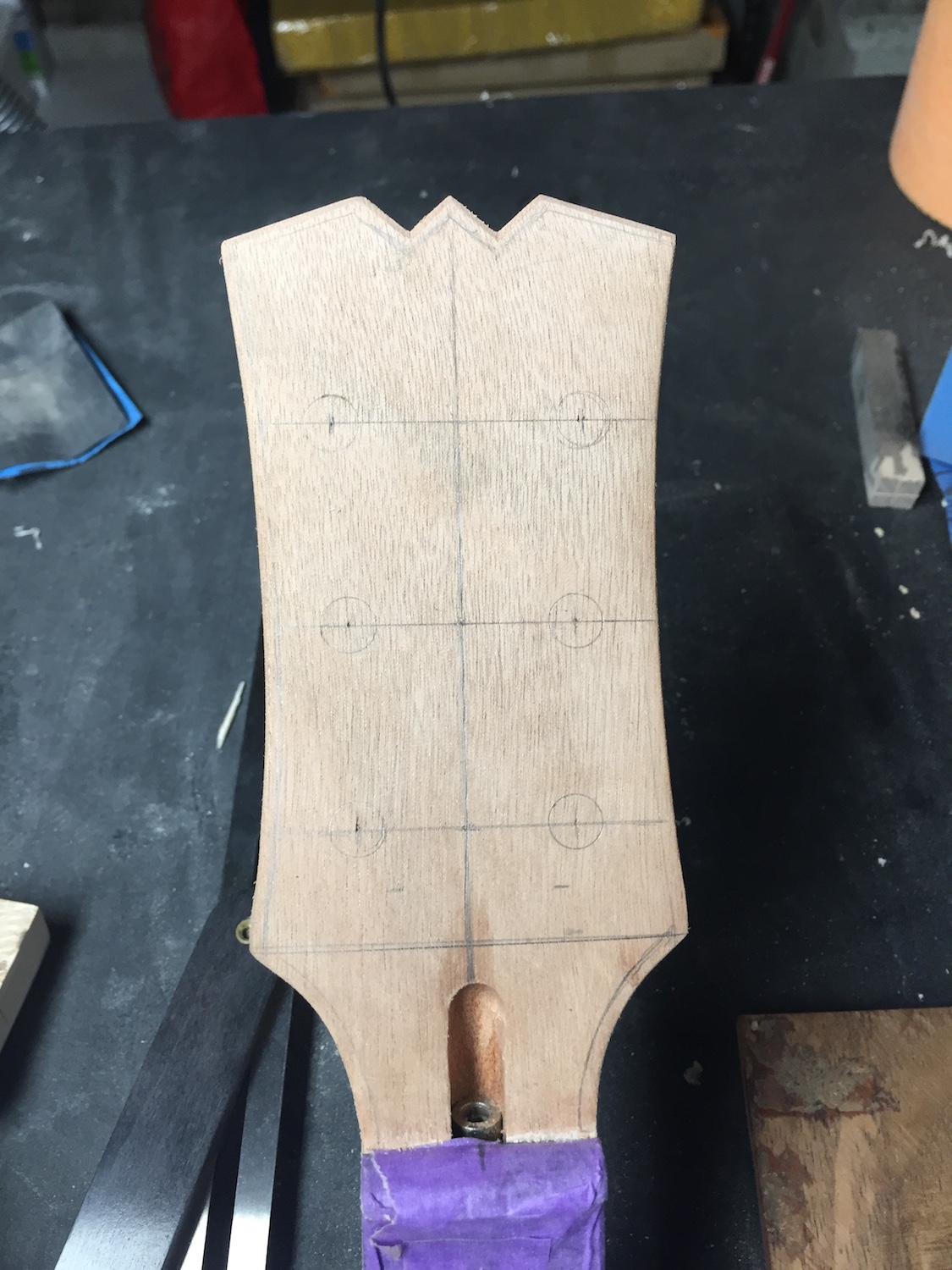

    Well I've sanded. I've agonised, I've sanded some more and I've plotted. State of play so far:
    - All machine sanding marks are sanded out.
    - Nut, PUPS, Machine Heads and Bridge decisions are made, along with wiring choice.
    - Body and neck are ready for a TM fill coat
    As much as it pains me to do so, the flamed top is going to have to be covered. The reason for this is that the bridge I want to use will need to have the existing anchor points filled and new ones drilled. A trans burst finish is not going to hide these filled holes.
    The spec for it was simple and unadorned, that also means eliminating a tone and a volume pot and running with only one of each, so two of the control holes will need to go as well. Probably something I should have considered at order, but what can you do.
    So far the only thing done that isn't Sanding or Plotting is this:
    I've got some sourcing to do, and its nearly Christmas, so this'll probably go on hold until into the new year when we shall pick it up again. Hopefully by then I may have finished an EXA-1!
    FrankenLab
  5. #35
    I like the headstock shape Frankie. Is this the final version? It's a great take on the classic shape, but with personal flair. Great work.
  6. #36
    5,666
    That's pretty much how it's going to stay.
    I was pondering putting a downward curve from the l/r points to the outer edge, but I kind of like it how it is.
    The pencil line around the edge was going to be a 45 degree chamfer but the spec is simple and unadorned so I'm going to drop that as well.
    FrankenLab
  7. #37
    Member G-Axe's Avatar
    Canberra, ACT
    413
    Love that headstock. I wouldn't change a thing.
  8. #38
    5,666
    Quote Originally Posted by G-Axe View Post
    Cheers G, similarly, the more I contemplate altering it the less inclined am I to do so. I think i really want to see how it looks blacked out.
    FrankenLab
  9. #39
    I'd still drill the post holes though.
  10. #40
    5,666
    Yurp, that bit i will do, but not until after i have sourced the machine heads.
    FrankenLab
