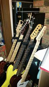

    I'm currently getting some pretty good results with Reaper and my very basic setup

    The Squier Thinline, STA-1 & Yamaha bass are the main weapons of choice
    In the band room I'm using the same little Peavey mixer & Senheiser mic with a laptop
