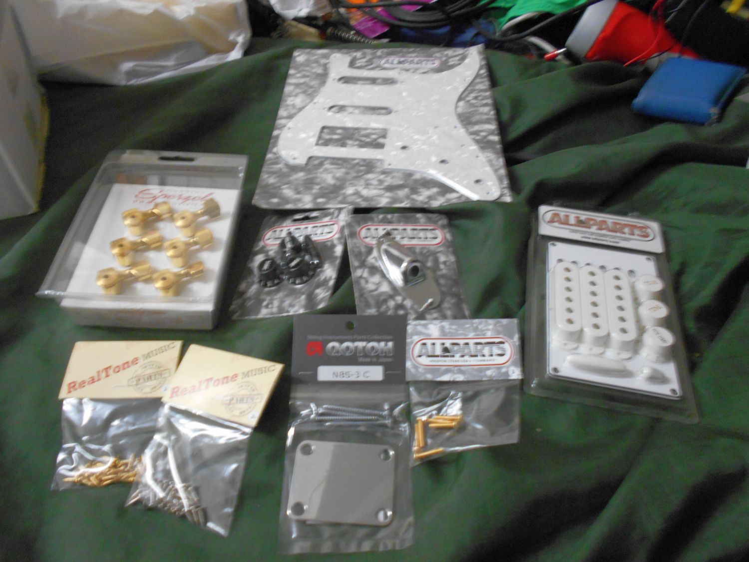

    Update:
    Woohoo!! A big box of some new guitar parts just arrived in the post, here's a pic of all the stuff that was inside the box:
Name:	New Guitar Parts_resized.jpg

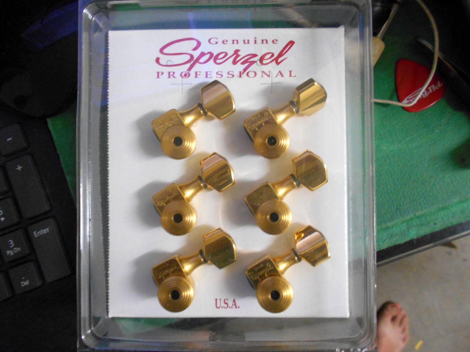

    These were what I was mostly waiting for, they are the new set of Gold Sperzel Locking-Tuners I ordered for the Gold Strat:
Name:	Sperzel Tuners_resized.jpg
    They have a gear-ratio of 12:1, that means you need to rotate the knob 360 degrees 12 times for the tuner-shaft to rotate 360 degrees once, it may sound like the gear-ratio is too coarse, but it's not really, considering that vintage Kluson Strat/Tele tuners also had a 12:1 gear ratio.
    On one end of the Tuner-Shaft is a small hole which you thread the string through, on the other end is a thumbscrew, this raises or lowers a thin steel pin which is inside the Tuner-Shaft, tightening the Thumbscrew raises the steel pin up into the end of the Tuner-Shaft which has the small hole for the string, this will effectively lock the string to the Tuner-Shaft so that you don't need to have very many string-wraps around the Tuner-Shaft, this will help to keep the string in tune better.
    There's one other difference with these Sperzel Tuners compared with Standard Tuners, they don't need any mounting-screws, instead, there's a short steel spigot poking out from the underside of the tuner where it sits flush with the back of the Headstock, the small spigot fits inside a small hole drilled into the back of the Headstock a short distance from the 10mm Tuner Mounting-Hole, the small spigot is to stop the Tuner from moving out of alignment due to string-tension, this would also cause the string to go flat.
    The Sperzel Tuners are attached to the Headstock via threaded bushings same like a set of Standard Tuners.
    Also, the heights of each of the Sperzel Tuners are staggered, so that you have two Tuners that are set the highest (E and A), followed by two that are set a bit lower (D and G), and two set to the lowest height (B and E), this is so that you can eliminate any friction-inducing string-trees from the B and E strings which would cause tuning-stability issues.

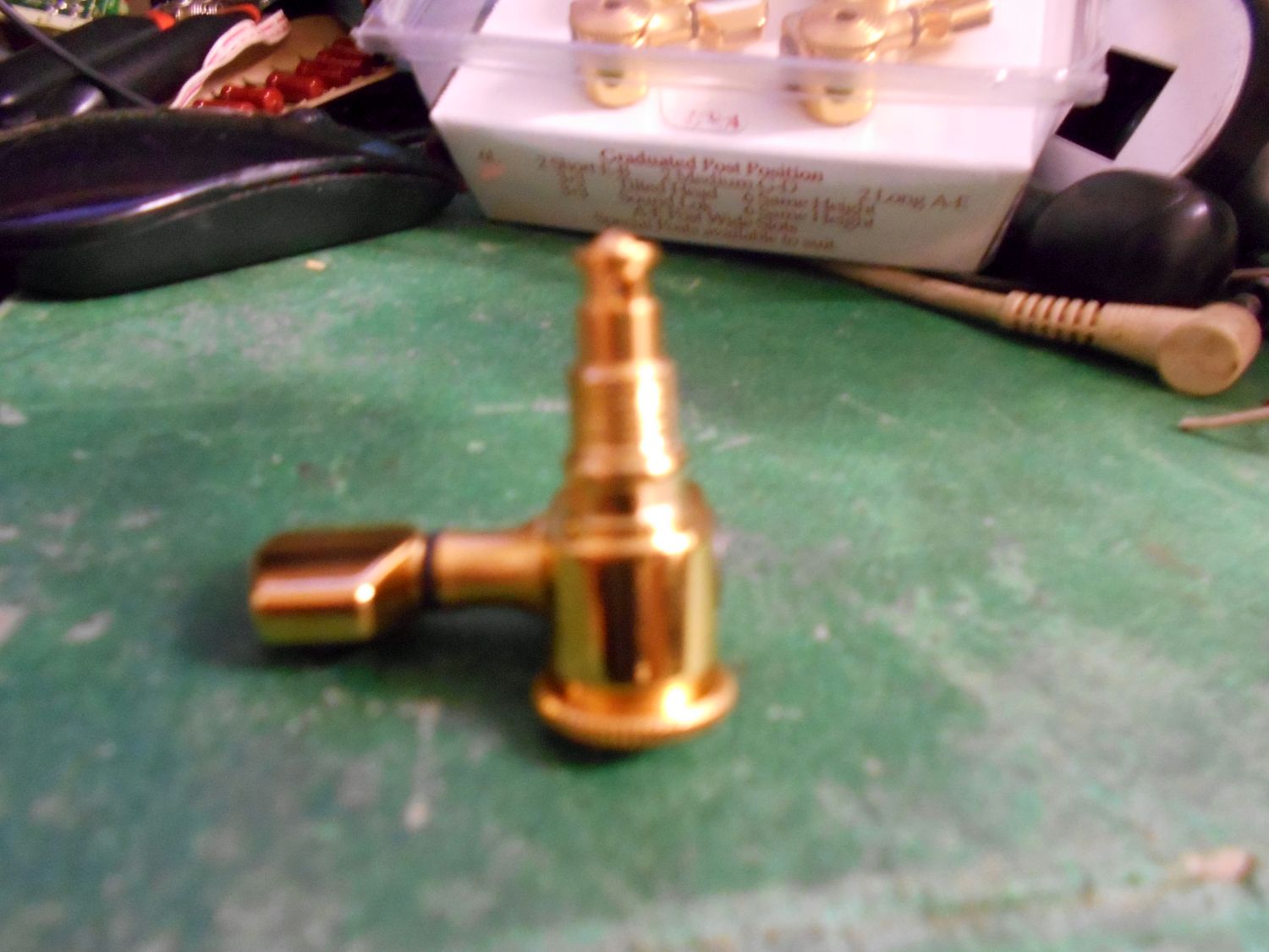

    Here's some more pics of the Sperzel Tuners:
    First, here's a closeup pic (sorry about the focusing, been trying to figure out how to fix it):
Name:	Sperzel Tuner Closeup_resized.jpg

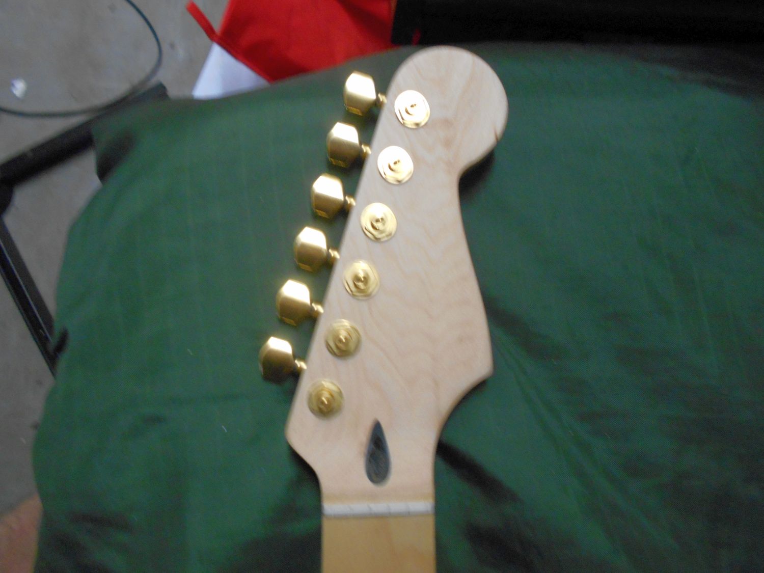

    Next, here's a few pics of the Sperzels installed on the Headstock of my Gold Strat:
    Front View:
Name:	Sperzel Front_resized.jpg
    Back View:
Name:	Sperzel Back_resized.jpg
    And Side View:
Name:	Sperzel Side_resized.jpg
    Notice how the Sperzel Tuners for the E and B strings seem shorter than the others?, that's to give a proper break-angle over the nut without having to use a String-Tree that would cause tuning-instability due to friction, I may not have to install any string trees at all, which is good cause my main aim was to eliminate them completely.

    Totally mate, Xmas did indeed came early for me, which means I'll be able to make some progress on my two guitar builds, the Gold Strat got the Sperzels, a set of six new Gold pickup screws, and some new Gold Scratchplate screws, the HotRod Strat got a new White Pearloid Scratchplate with pickup holes for a Humbucker, Single-Coil, Single-Coil pickup configuration, a set of Black Strat Knobs, a White Trem Spring cover, some new Chrome Scratchplate screws, A Chrome Jackplate with screws, and a Chrome Neckplate with screws, hopefully I'll get the HotRod Strat finished before the end of the year.
