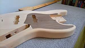

    The plate is flush with the body ... now wondering if I should also cut a recess for the control plate and make it flush with the body too ...
    I'm planning on finishing the body using DingoTone colourless ... hoping that it'll pick the grain in the different woods and make it look great. The colourless DingoTone finish on the neck is really nice, so hoping to get the same sort of look on the body.

  7. #35
    What a great idea and it looks good too.
    Definitely agree that the control plate will now need to be recessed too otherwise it would look odd sitting on top.
    Suggest tracing around the edge with a pencil rather than your Stanley knife and just dremel to the inner edge of the line to avoid any more timber mate filling.
