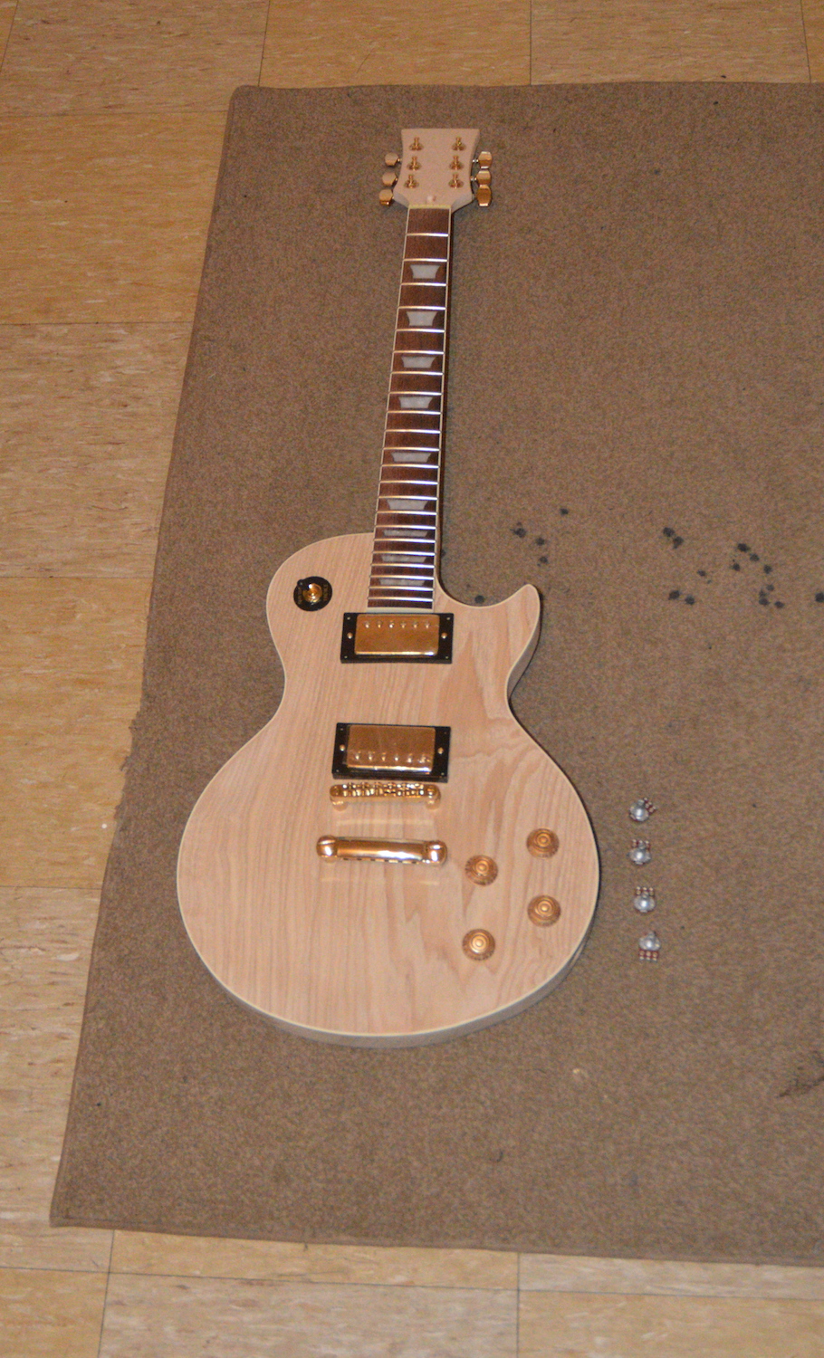

    YAYAYAYAY! It's arrived!
    I'll be doing a mock build shortly, but (crappy photos aside) here's the general body before starting..
    (Pictures courtesy of my wife, whilst Im at work)

    Noice. Do a damp cloth wipe down on that front before you start. It'll highlight any potential glue issues and it should give you an idea how the grain will look. Plus if it sets up nice you'll give everyone the grain envies when you post the photos.
    Sweet looking kit mate, what are your plans?
    Ohhhh gorgeous grain on that ash.

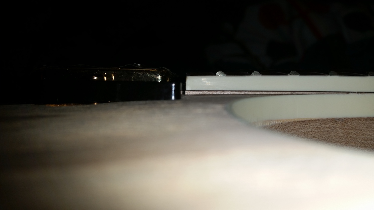

    So I am doing my mock build (After getting into adam's ear, I was pointed in the right direction) and I've got a question about the neck angle.
    After looking at the guitar for quite some time, Im wondering about this neck angle / space - Neck is tighter than a nun's credentials, but when it's in the guitar, I get about this much space between the body and the fretboard (see Image).
    Before I go sanding the puppy down and smoothing the face / removing the glue spots, can someone please tell me if this is going to be an issue? Should I be doing anything particular regarding this space?
    (See image)
    Thanks in advance

    Doesn't look too bad, is the back end of the neck sitting flush on the bottom of the pocket?
    You really need to run the e strings down it and see if every thing lines up and that your neck angle is within cooee, if those are good and your scale length is okay and you don't have a funny string break angle, then you should be good to go and that gap essentially becomes cosmetic. This is where the mock build, with neck clamped and strings run is helpful.
  7. #17
    I don't think that little gap looks bad either, the way I see it, that gap will probably get filled up with the glue you use to glue the neck to the body anyway, the best glue to use is Titebond since it is stronger than the standard PVA Wood Glue, you can order Titebond from Dingobass.

    I'd probably leave installing the bridge pegs till after you've done all the initial finishing work on the body and neck, reason for that is because you're most likely going to have to give the body and neck a sanding-down before doing the staining, and the bridge-pegs may interfere with the sanding, you can however do your mock-build to check that everything is going to fit properly, and the strings will be correctly align, you might need to drill some mounting-screw holes, which is probably best done before the finishing work so that you don't end up ruining a good finish.
    The neck angle looks similar to the neck angle on my Gibson USA LP Studio.
