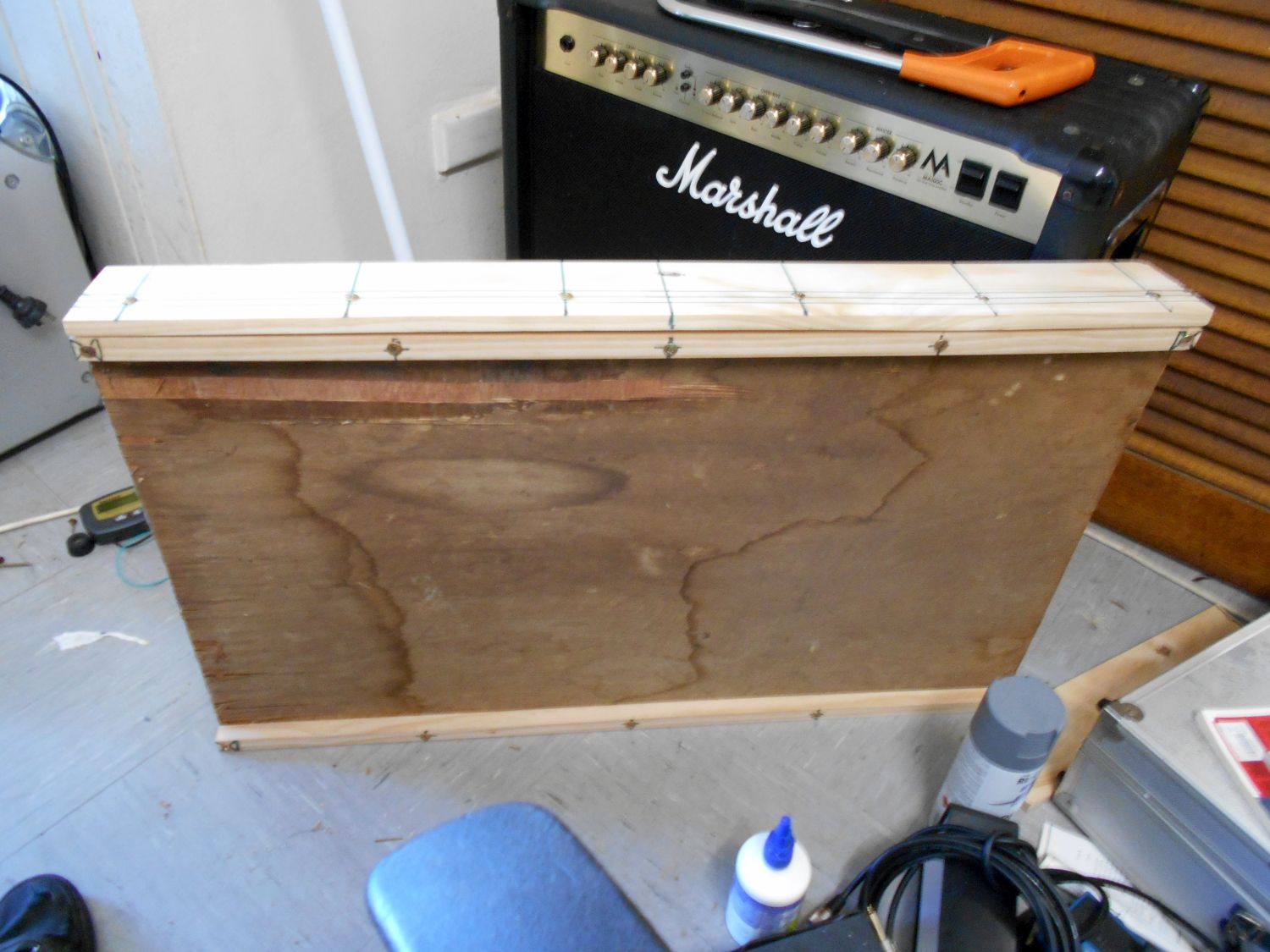

    Okay, here's a few pics I took of the build-process of my Pedalboard:

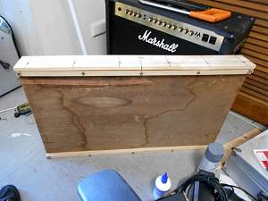

    First thing I did was to mark-out, cut, and drill two long pieces of square timber to go on the long sides of the rectangular half-inch piece of board I was using to make my Pedalboard:

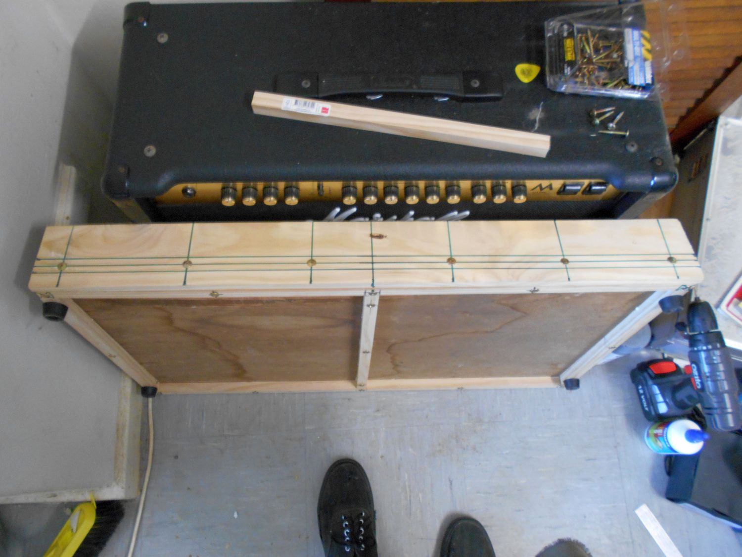

    Next thing to do was to put some PVA wood glue on the square piece of timber after drilling some mounting-screw holes:

    I used some wood screws to attach the long pieces of square timber to the board, I also attached a 12mm thick piece of wood to the front of the board, this will hold the power board.

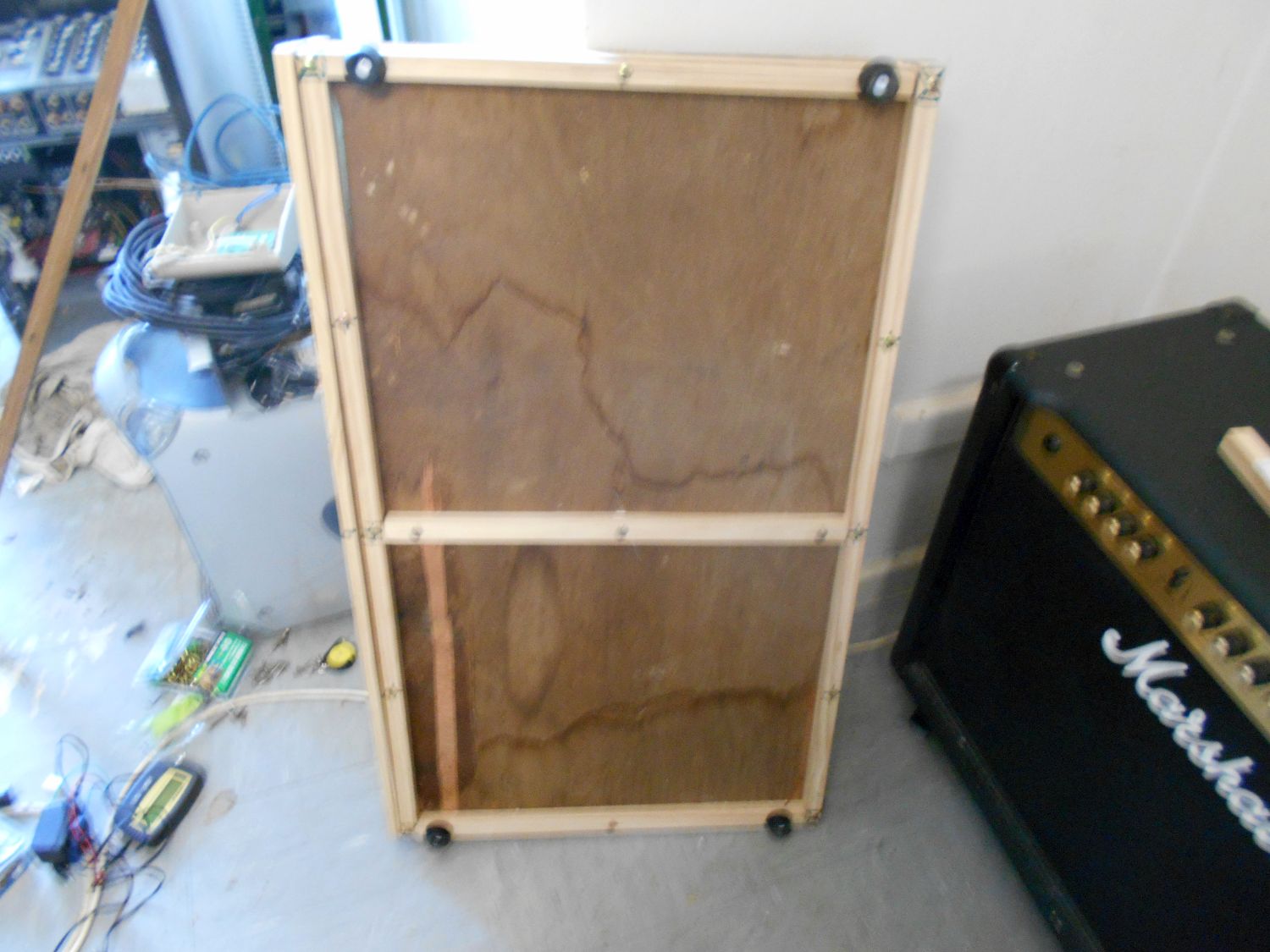

    Next thing to do was to mark-out, cut, and drill some shorter pieces of square timber which were glued and screwed into place on the shorter sides of the board:

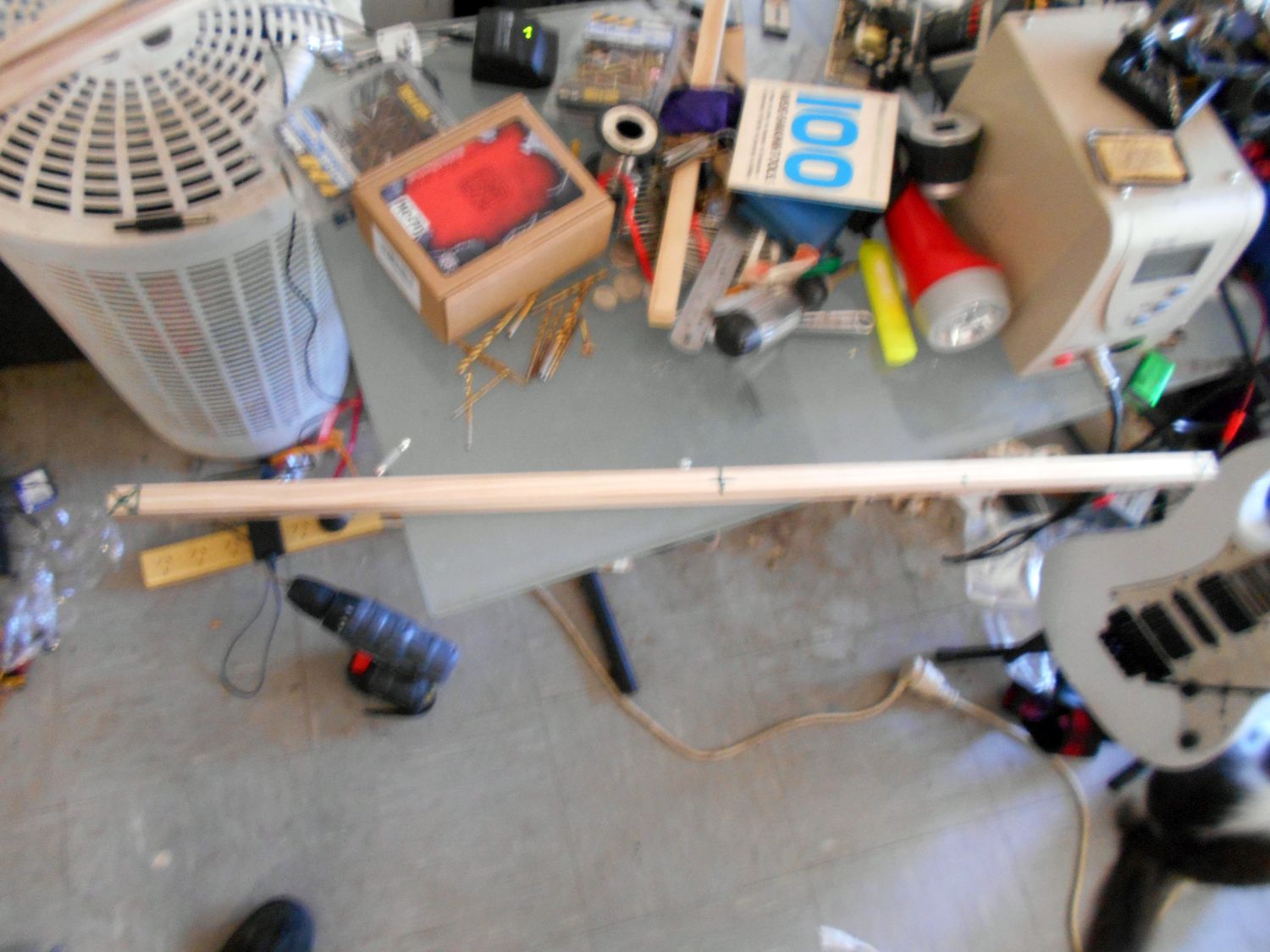

    The board now looked like this:

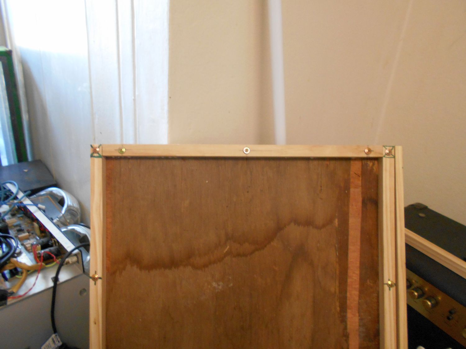

    Next thing to do was to mark-out, cut, and drill a third short piece of timber, and glue and screw it to the middle of the board:

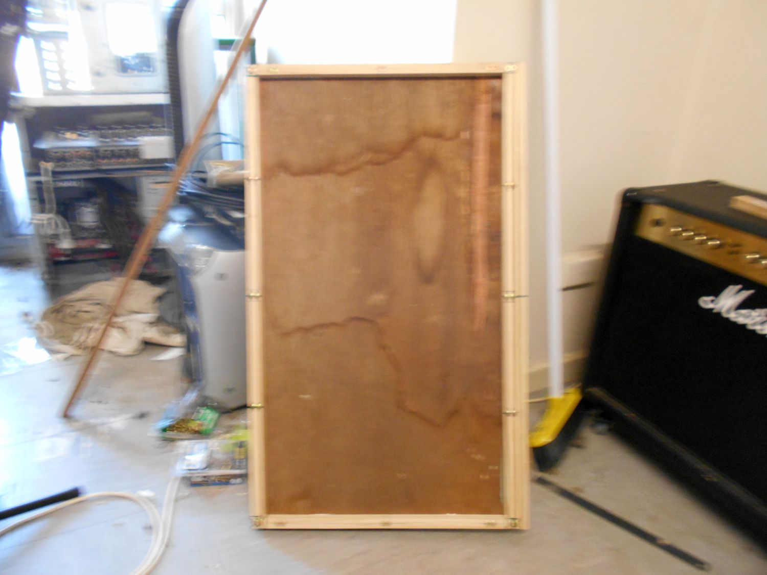

    I then attached four rubber feet to the board, that I had left over from putting casters on my Marshall amp:
