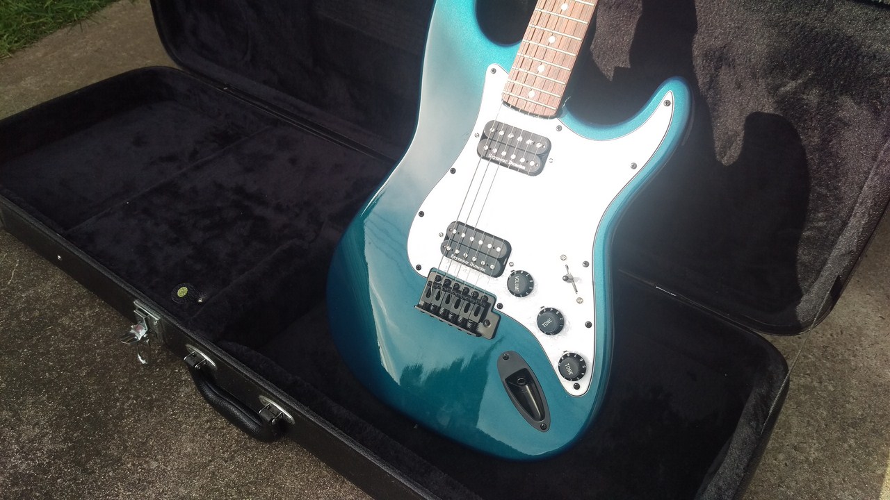

    ST-1 By NitroBurner1000
    Hi guys, this is my first build and with plenty of help from the guys here its finally finished.
    Quick rundown..........
    Aftermarket Pickguard to fit twin humbuckers, white pearloid
    Seymour Duncan JB and Jazz HotRodded Humbuckers
    Upgraded to Grover Tuners
    Black hardware
    Copper shielding to humbucker bays
    3 aftermarket push pull pots to ...1) split the pups 2) series parallel options, 3) in and out of phase.
    Vintage cloth wiring
    Treble Bleed mod
    Plastic nut replaced with a bone one
    Replaced stock 5 way switch with 3 way.
    PAINT FOR BODY....
    6 coats sealer/primer,
    6 coats of black basecoat,
    4 coats of metallic undercoat and
    6 topcoats of clear 1k acrylic full gloss.
    Sanded between coats, bodyfilled and finally buffed and polished
    NECK AND HEADSTOCK
    Stained and finished off with wipe on poly, logo freehand drawn.

    good stuff Nitro, you just need to post a close up pic of the headstock and back of the guitar
    EDIT don't worry the pics just appeared.
    Great effort for a first build well done !
