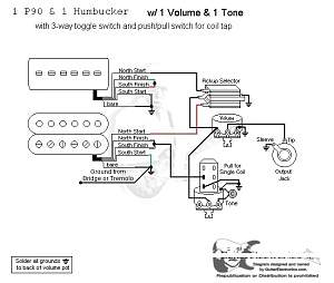

    For my next build, considering using a P90 in neck position and a humbucker at bridge.
    Thinking of Kent Armstrong noiseless P90 (4 wire) and maybe Tonerider AC2, also 4 wire, one vol, one tone, 3 way switch, with a push-pull to split humbucker to slug coil.
    Haven't found a wiring diagram for that combo, so have edited a 2 HB diagram to suit, I think.
    Will this layout work, or is there a better way?
    Any advice greatly appreciated.
    Grant

    Hey Grant, I think that diagram should work with no split coil on the P90. What kit is it going in ?

    Grant, that layout will short the bridge hot (north start) to ground when the push/pull is up, not what you want. Instead of the red link wire to the middle lug on the push/pull it should be the north finish/south finish series link, then with the push/pull up it will connect the link to ground giving you the slug coil. Diagram 3 on the Tonerider humbucker diagram should be the setup you want for the split to slug coil.
    good one Weirdy to the rescue. I've used diagram 3 on Tonerider pups in bridge position
    Thanks Weirdy, have re-edited drawing to suit

    Yep, that should do it. Just remember to check for any phase issues when you're mixing different brands of pups, you will sometimes need to reverse one of them.
