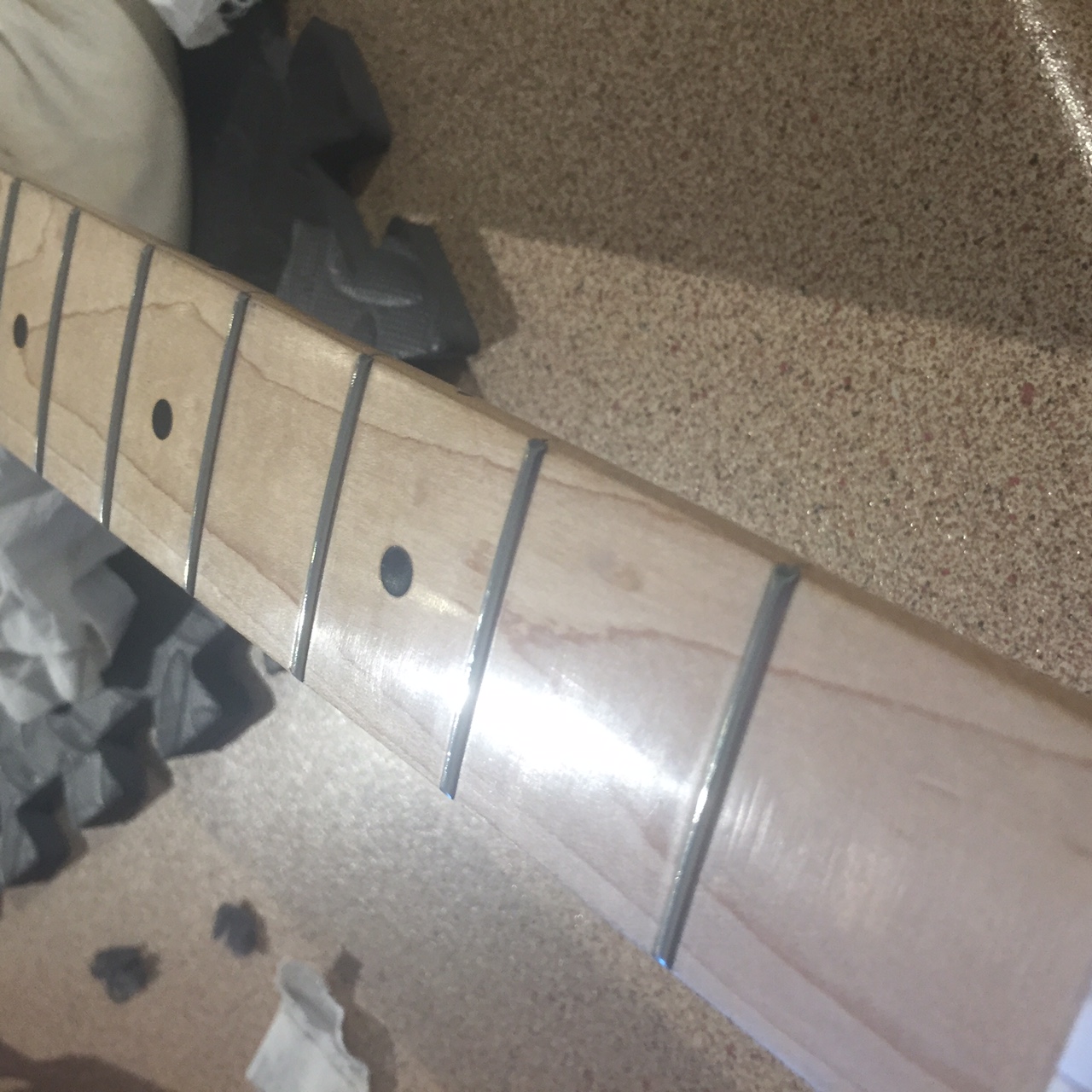

    Nothing wring with tru oil on the neck and dingowax on the fret board. I would not use Tru oil on the fret board.
    This is what a Dingowaxxxed maple fretboard looks like....
