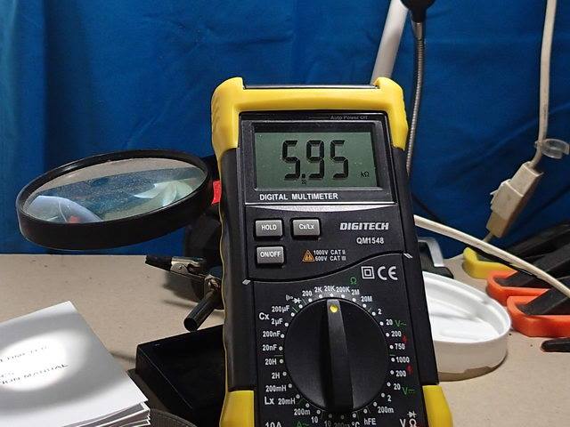

I gave it 7760 turns scatter wound, Vintage average is 8000 turns, polarity is South facing
Gauss reading peak average 942 very good
OHMS 5.95k at 20C
have a henries reading here somewhere but cant find it which to me is more beneficial and tells me more than an Ohms reading.
