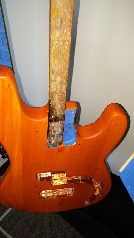

    Let the finishing begin. :)
    I have wiped on and waited seven days for the body and the neck to harden.....nice feel to it this time. The body and the neck got a mild scratching and then the neck has had a single soak coat of naughty oil. It will get two more tomorrow and then hang for 7 days to cure.
    The body has had a single coat of the Intensifying Coat and will now hang for a seven day or longer period....getting a little chilly here now....busted out the sandals....thongs for summer.
    Think 3 naughty oil coats and then 3 wipe-on poly coats for each will be good.....smooth glossy finish. Then auto compounds, polish and wax all round.
    I love the grain, smell and feel of DT...it is setting hard and did get a lot darker each day. Different to last time. Love the stuff.
