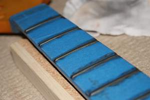

    Fret Leveling
    This is the one that scared me. I watched so many different videos on this. Once I got the fret rocker and went over the fret board I found so many frets were not level. Never very much in it and who knows if this would have made a significant difference, but if I am doing this, then I am going all the way.
    The board all taped and marked where the frets are high - you can see the marker is everywhere.
Name:	Fret Level 1.jpg
    After sanding. Videos have told me to sand till there is at least a thin line through the marker pen
Name:	Fret Level 2.jpg
