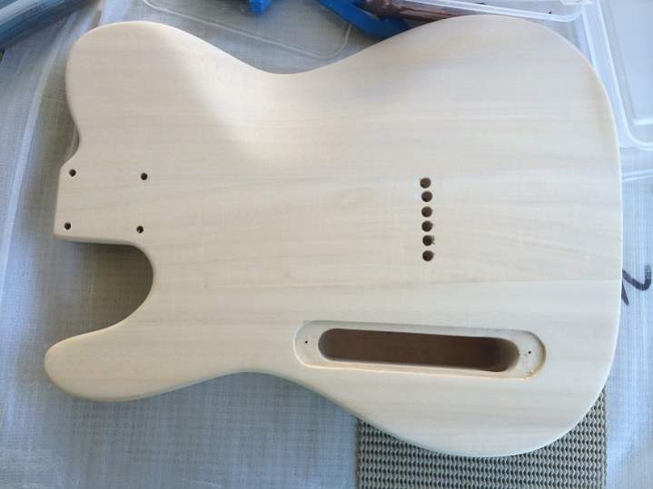

    I’ve had a bit of a break so it’s time to get back to Lyn #10.
    Over the last couple of days I’ve put a belly cut in the back and sanded down to 400 grit and grain-filled with Walnut TimberMate. I want to enhance what grain there is in the Basswood body and thought that a dark fill like Walnut would give it a bit of a boost.
    Yesterday I started veneering the headstock. I hadn’t looked at the sheet of veneer since January as I was a bit disappointed when it arrived. Unfortunately on closer inspection there is a large area with the best feature that is just not usable. It is very brittle and there are holes all through it. But luckily the remainder is not too bad and although not what I was after there is enough for the guitar body and I am starting to warm to the parts that I can use.

    Pic #1 - Back before grain-fill
