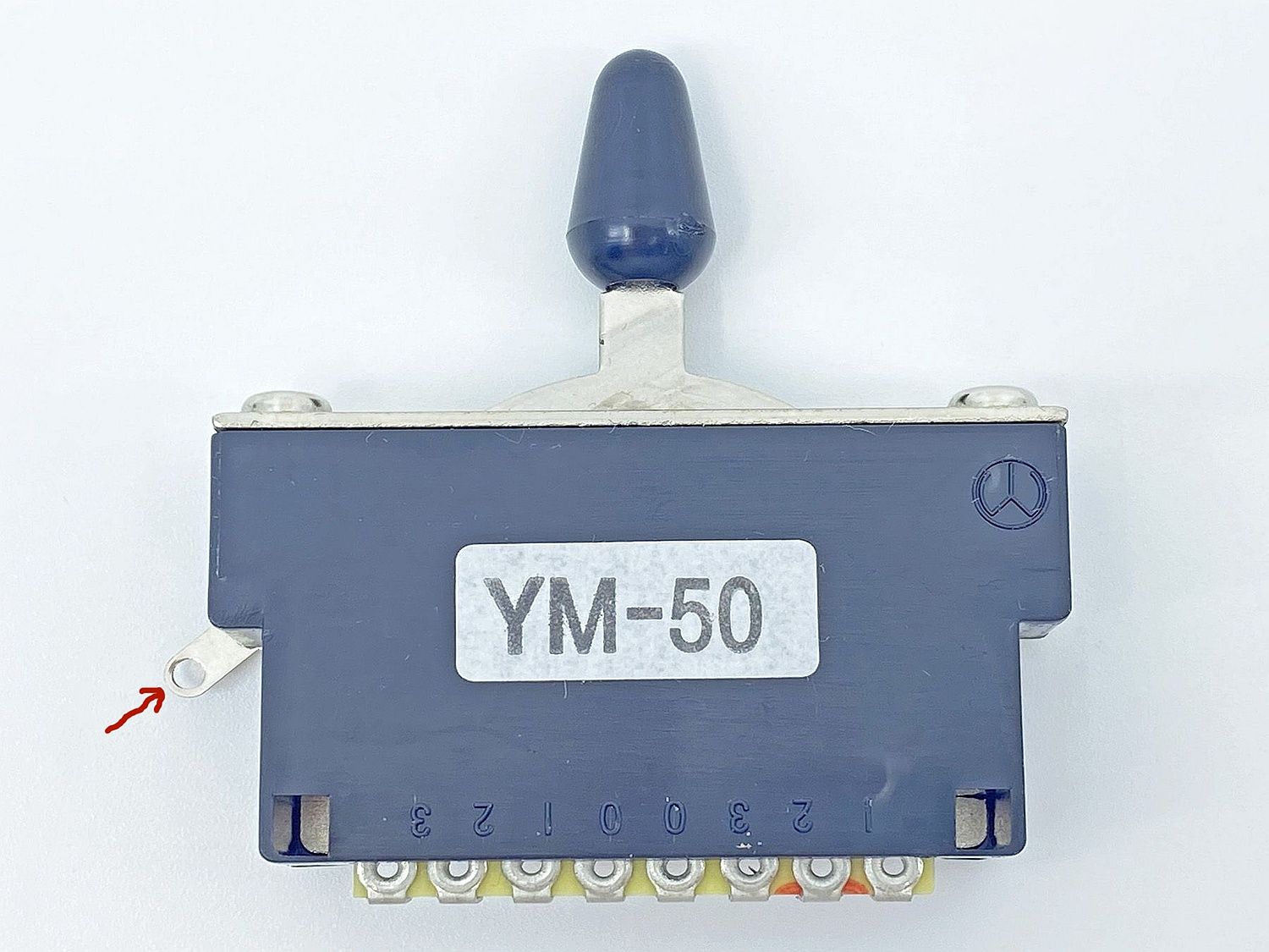

I am currently working on a tele build and thought I might try something different with the wiring.
I came across the Bill Lawrence mod and would like to try that one on the tele.
This is the switch that I have

I would appreciate if the wiring gurus out there could advise me if I have got it right or wrong.
Also, the lug marked with the red arrow looks to be the earth/ground point - please correct me if I am wrong.
Many thanks in advance.
