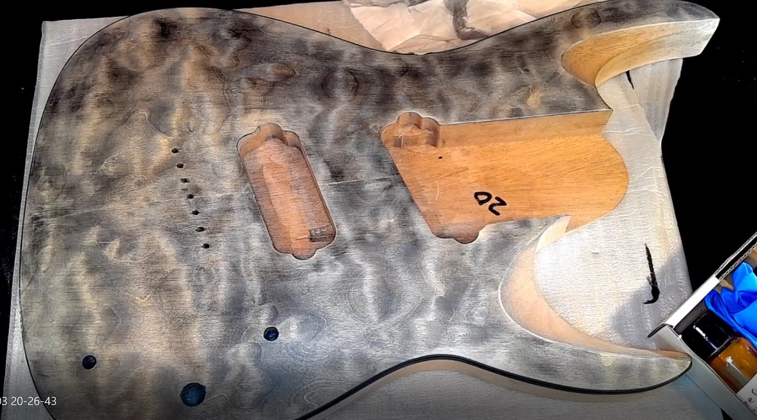

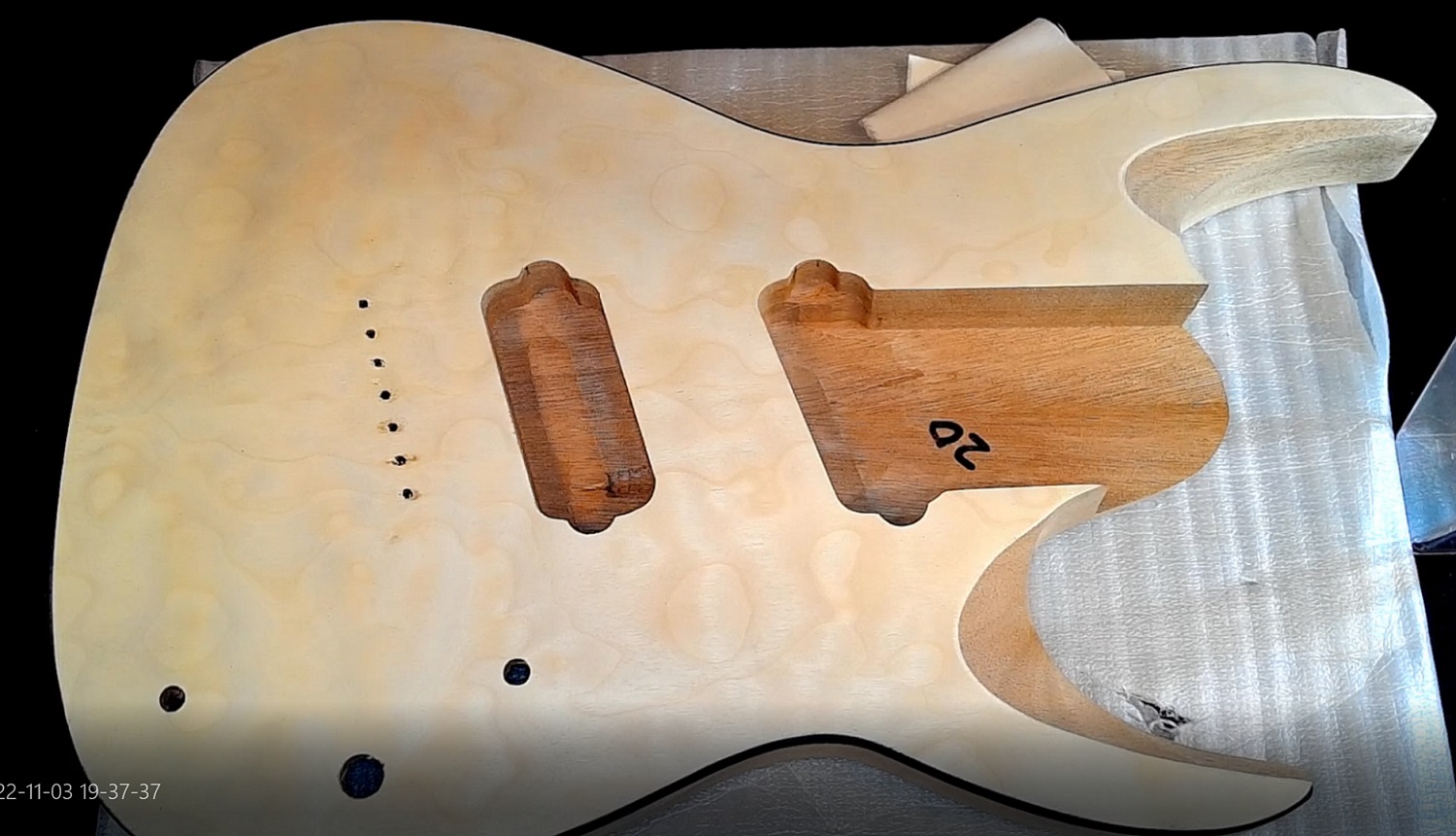

    I pulled it out the other day to start the work. Only after applying stain to the veneer, did I find a very visible glue line running down the front of the guitar, where the two pieces meet (See attached).

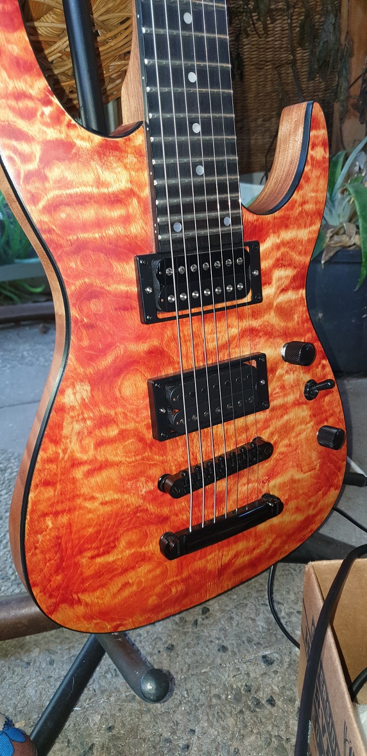

    There was no issue with my first kit when applying the stain over this seam. Dingotone is used in both cases (Also attached). On the first kit, I also used tung oil after the red stain. Unsure if this helped mask this join, but I don't remember it ever being noticeable at any point during the build.
    Are there any tips/tricks to fix this, or minimize it? Or is this just a factory flaw that I'll have to embrace?
    Thanks for your time!
    *I was directed to a few solutions others have applied to this problem that I will list below*
    (Thanks Trevor Davies for linking these in the original thread!)
    - https://www.buildyourownguitar.com.a...ad.php?t=11308
    - https://www.buildyourownguitar.com.a...l=1#post218058
    - https://www.buildyourownguitar.com.a...l=1#post208202
    Having a read through these posts gives me hope. I kind of like the hairdryer option. Warm the glue and delicately scrape. I don't mind if I can still see it, I also wouldn't mind if it looked intentional, like a feature stripe. Up close, the line varies quite a bit in thickness and looks like a mistake ATM (less obvious in the photos than in person).
