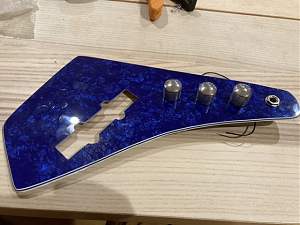

Quote Originally Posted by IngridM View Post
Did some more coats of Tru Oil and I’m now on day 12 of curing time before I polish. On the neck/headstock I ran out of steam and won’t be doing enough coats to bury the decal but I’m fine with that. Last night I added the pots to the pickguard while I was twiddling my thumbs. Counting down to polish and assembly.Click image for larger version.
You can spray some poly over the decal to bury it.
I use the exterior marine grade aerosol cabots from the Big Green Shed. They do satin and gloss in the aerosol. I spray 3 coats ten minutes apart...wait two days...wet sand 600 grit...3 more coats....wet sand 800...repeat to 1500 grit if you need.
This is the gloss....
