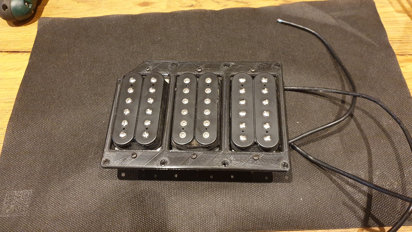

I gave my 'old' LAG rockline body a total makeover:
- stripped all lacquer and paint
- turned HSS into HHH with rainmaker (N) - liquifire (M) - dreamcatcher (B)
- 3D printed PU guard
- 3D printed electronics guard
- Refinished
- Rewired with series/split/parallel on all PU's and individual tone/vol concentric pots

Loaded PU guard:
Name:	Loaded PU guard.jpg
