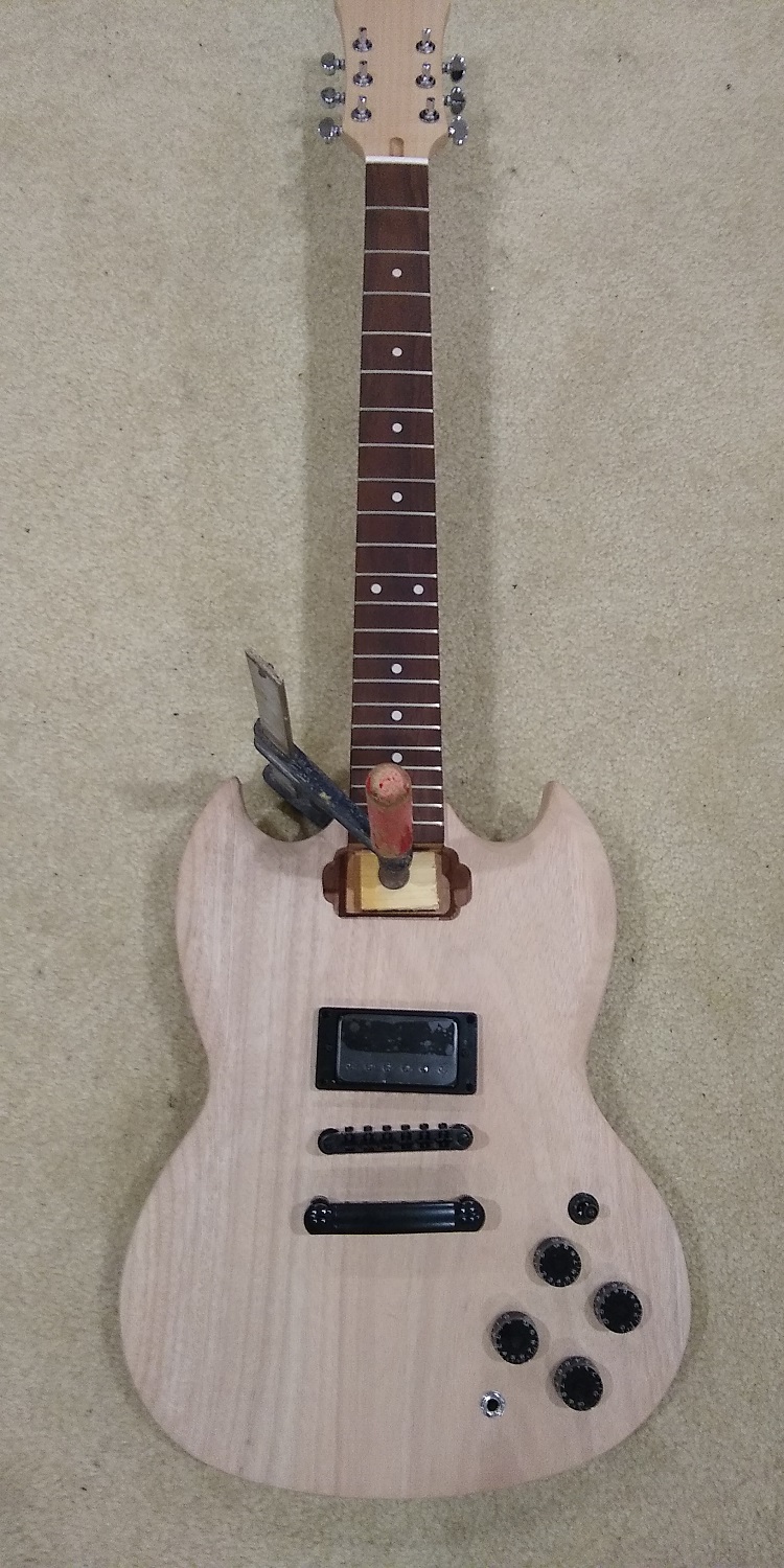

    Dry Build
    All looks good, nice tight neck pocket. All parts fit as expected. I wasn't expecting wiring to be provided in such a complete state - and quality look good.
    Now comes the first big question? How to correctly set the scale length? Currently looking at 317mm from crown of 12th fret to centre of bridge hole of high E string. Seems to leave the correct gap for the neck pickup but it would be nice to really confirm this as this is a glue in neck.
    Anyone earthed the tailpiece?... similar to that done here https://www.youtube.com/watch?v=XjV-LK5LHqI ... you will need to drill your own hole from the electronics cavity to post hole.
