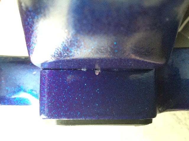

    So I’m at the stage where all hardware parts have been attached apart from the string trees. Will attach these once strings are on so they are lined up in exact position. So I’m stringing up now and noticed that the strings do not ring out any note whatsoever and just buzz completely, even if you fret on any fret it’s just the same buzzing. I had a closer look and can see the strings are basically laying on the fretboard, the last two or three frets the string is just sitting on top of those frets.
    So usually you’d probably look at the set up stage, ie truss rod adjustment to fix this issue. I’m beginning to question though, if I have attached the neck correctly being the string just sits on those last few frets. The screws on the neck plate seem tight and the neck itself seems flush to the body, just not sure though if I drilled those holes far enough.
