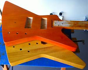

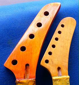

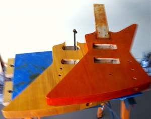

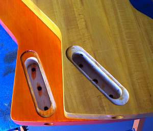

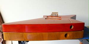

    That Washburn does look a bit like a butchered Lefty Explorer. Explorer shape is surprisingly ergonomic considering it's rather long and angular shape. The EX5 is very, very neck dive heavy and suggest locating the strap button in the middle of neck mounting plate as I have done recently. If placed on the upper horn/lump I found it wanting to drag down all the time and couldn't seem to find a balance point. All good now. Guitar is not such a problem as the neck is way shorter but I may still get around to relocating strap button too.
    In case you were interested in doing a matching guitar here are the comparison shots taken late Jan 2016....

    Thanks for the comparison photos. I think you answered a question I had about the EX-5 fitting in a Pit Bull hard case. I believe it’s probably their largest solid body bass and aren’t sure it’ll fit. It looks like it isn’t that much larger than the EX guitar so I’m guessing, yes. After all this work, the thing is going in a case! (Unless my paint job ends up looking like a two year old painted it with a water color set!)
