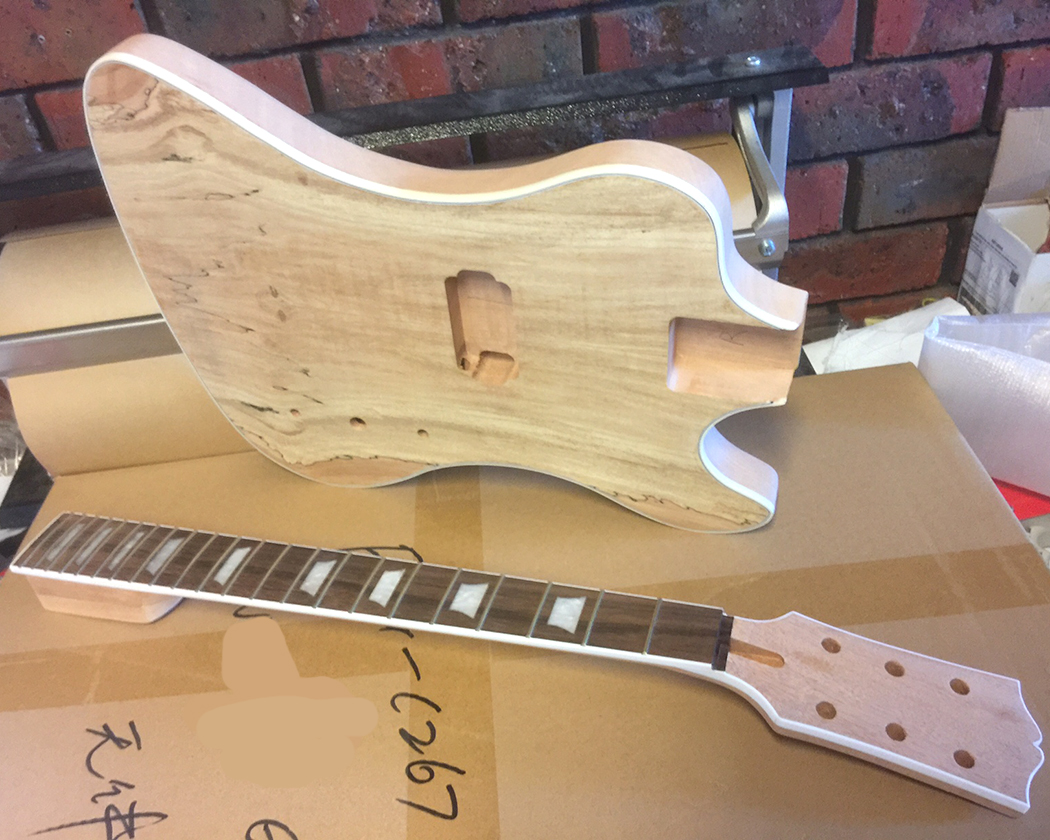

I was cruising through the PB site one night and came across this kustom kit that the factory had gotten wrong, the buyer had wanted a different veneer, I wasn't going to do any more builds this year but....I have a weakness for single pick up guitars and you know gotta have something to do on those days where it's cool enough to work in the garage.
It has a glue in bound neck, is fender scale, a single humbucker routing with the typical 3 holes for pots. There was the first issue. I don't need a 3 way switch on a single pick up ( I'm using a humbucker sized P90). So, I've filled the jack socket on the edge of the body and will run the jack in the end hole in the top and have the Vol and Tone as well. I had a gold Schaller tail piece in my pile of stuff so I ordered a matching bridge and have drilled the holes .A fair bit of glue refused to come off but I've managed to disguise it fairly well I think. Gold open back tuners are coming and I have a bone nut to go on and should all look good with the dark walnut stain.
