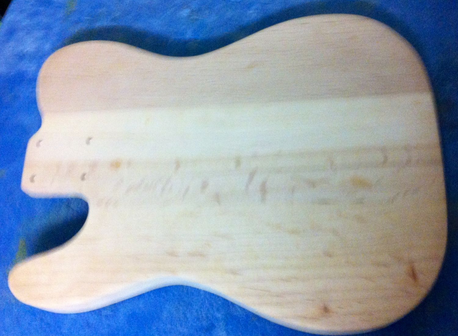

Upon opening the box this is what I found....

What it looks like damped down....

Hmmm, mismatched coloured planks used has me now thinking something more dark & sinister.
I loved what Kenfu did on his LP-1S with the spalted maple top and traditional mahogany neck & body using a natural chemical wash and then Arzi produced his awesome Ash Barncaster. For this build I will attempt to do the natural chemical wash using Tea, steel wool & white vinegar and see how it reacts with Alder hoping it comes out quite dark grey/black. If it looks crap plan B has already been drawn up and plan C would end up solid black. Also have a couple of radical bling ideas in mind too, but more shall be revealed on those as we move along.
