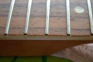

So, referring to the photos below, today I pulled the neck off. Surprise surprise, someone had a similar idea, as the two paddlepop sticks will attest. Even though it's been 25 years, pretty sure I've never had the neck off. So someone was not happy with the action at some point in time.
Also, that big hole in the middle of the neck mount screws, dunno WTF that is for. Can't even think why it would be there, obviously not original with the way the paint is chipped around it, and not centred.
As for the neck itself, I think it's definitely original, as the "mother of toilet seat" (onya DB!) veneer on the headstock is identical to the pickguard material, so would have to think it's the original neck.
Waz, it's definitely flat - after taking it off the body I put a steel rule along the frets, all touch at the same point, no gaps.
BUT, and a big but, as you can see from the third photo, the frets are horribly finished - running your hand up and down the neck is not a very nice experience. They have jagged edges and varying lengths. All in all not a very nice neck.
