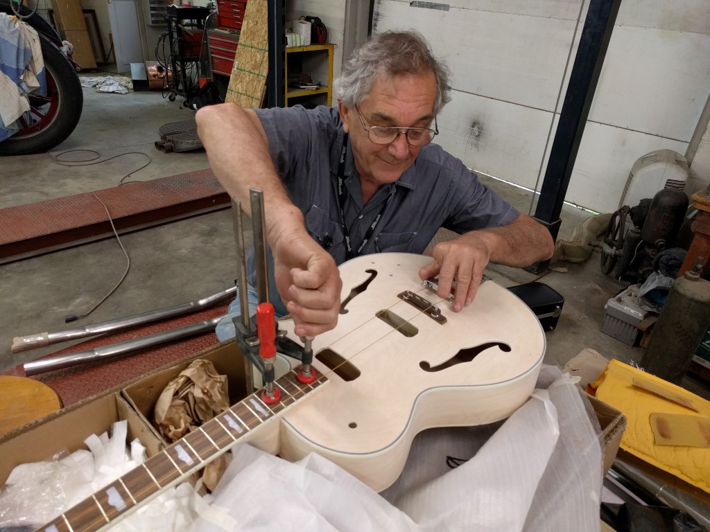

Next, we bolted the neck on to check neck alignment.
The neck was actually a tiny bit too big to fit in the pocket correctly, so some careful judicious sanding was needed. Also, there was a bit of...slag? in the pocket (wood bits in the corners that hadn't been routed out correctly), so a bit of time with a file was needed to clean that up. Once we were sure the neck was seating in place properly, we threw some clamps on it.
