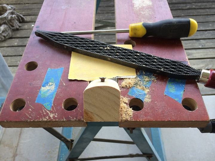

I thought it was about time to try my hand at binding, so as this guitar is very much a test bed, I thought why not?
First hurdle? How am I going to cut a channel for the binding without a router? Answer, same as with everything else, with a chisel.
I needed to cut a guiding gouge so as to reduce tear out. I would dearly love to be able to afford to buy a descent gramil but even with one of those, with its flat surface, I was going to have a problem with the horn and the waist-line of a guitar. I found the answer on Google and made myself a “poor man’s” beading tool. I had to modify it by rounding of the surface to fit the contours of a guitar but it worked pretty well.
The screw that does the gouging is sharpened by simply lightly filing the top surface flat until there is a slight cutting edge around the circumference of the screw. Apart from its simplicity the beauty is it is quite accurate and by turning the screw 1/2 turn I could go from 5mm to 4mm in seconds.
And here it is from a different angle showing how I had to round off the edges for the horn and waist.
