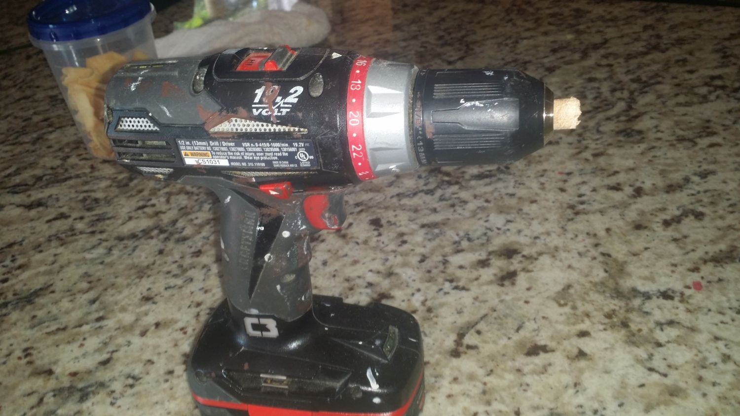

    I used the long plug cutter to make a few 1/2" plugs. I then put them in my drill, and spun them while holding a piece of 150 grit sandpaper against them until they made a tapered plug that would fit into a 12mm hole.
