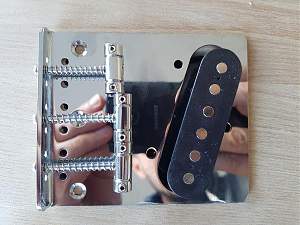

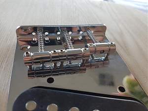

I wound the saddles forward to the point that the screw was flush with the end of the saddle as you can see here
Two of the saddles come forward far enough that from the edge of the saddle to the middle of the 12th fret is 330mm
The shorter saddle to the middle of the 12th is 325mm
