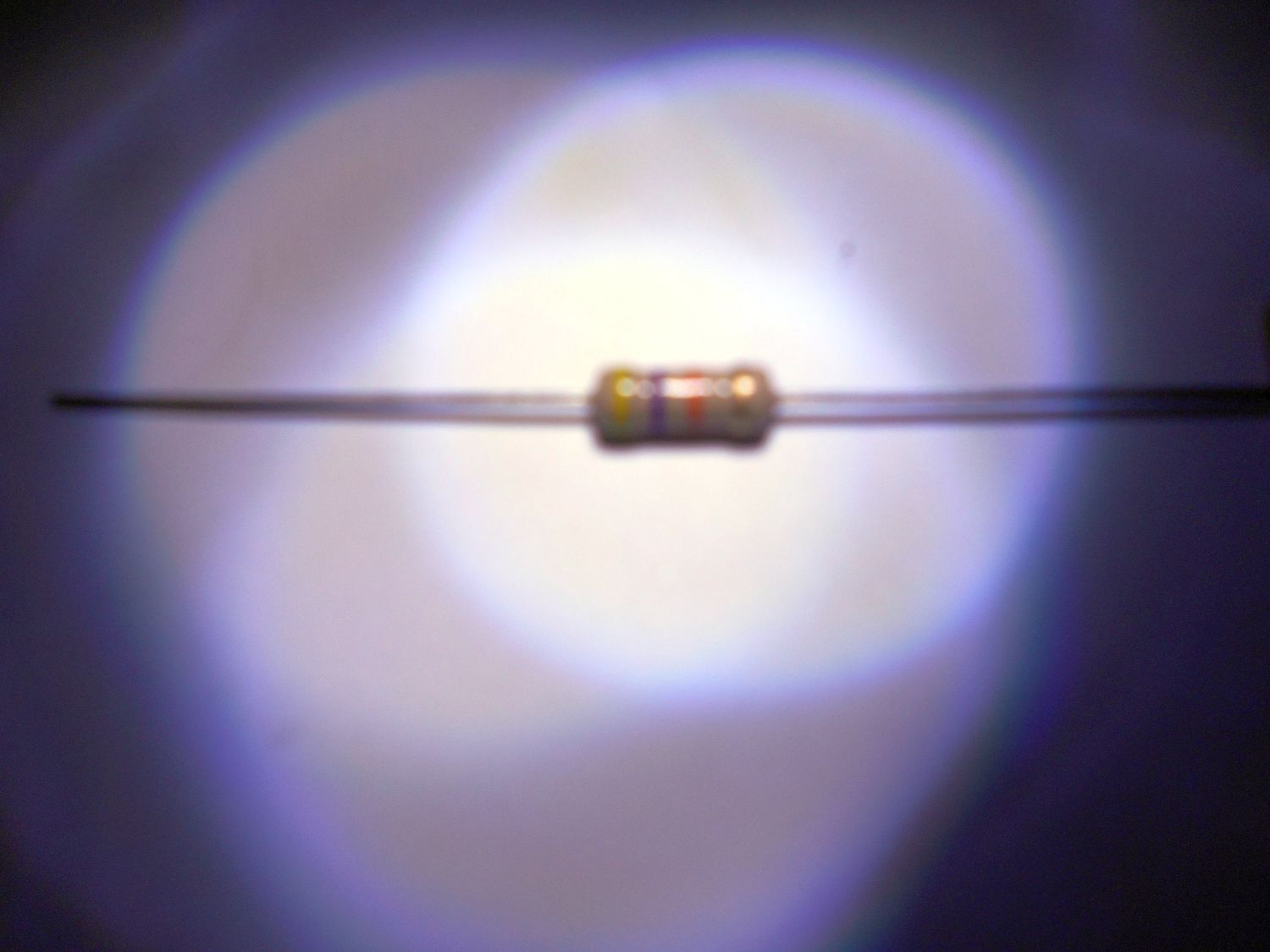

    Here is a pic of a resistor to show you what they look like:
Name:	47k Resistor_resized.jpg

    The resistor is marked with four coloured bands, the first three coloured bands indicate the value of the resistor and the forth band indicates what's called the tolerance, or how much + or - of the marked value the resistor can actually measure.

    Using the resistor in the pic as an example, it is marked with the following colour bands:
    Yellow, Violet, Orange, and Gold.
    Which indicates the following value:
    4, 7, 000, and 5%
    This decodes as a 47,000 Ohm resistor with a 5% tolerance, or 47k / 5%.
