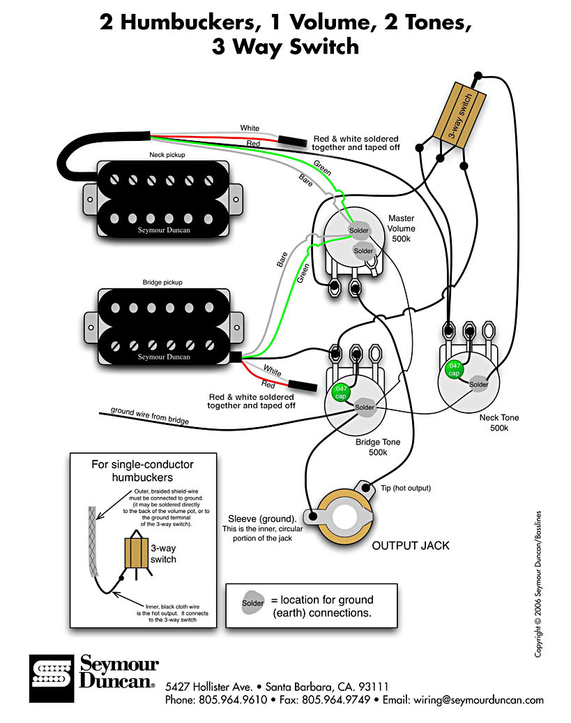

    I couldn't help but notice that there is no wiring diagram for the FV-1G (Gibson style Flying V) as it is placed in the same diagram as the "2 Humbucker 2 Pots One Toggle" though it has three pots. As I've said before, I've had my eye on one of these kits for a while, and if it's not too much an ask, would like to know what I would expect to deal with. Thanks /,,/

    If i cant find a diagram to suit or want to look at other configurations I usually jump on this site which has heaps of wiring configs.
    http://www.guitarelectronics.com/cat...ring_diagrams/
    For FV-1G I used this one.
    http://www.guitarelectronics.com/pro...mes1-Tone.html
    Tony
    Hi Zac, I used this diagram attached.
    Depends if you want a master volume and 2 tones (this one) or you could have a volume for neck and bridge pup and master tone

    Hi Zac, I find the Seymour Duncan diagrams clear to work with. Have a think about volume for neck and bridge pups and master tone, as 2 tones is bit of a waste IMHO. Or you could use the 3rd hole as a kill switch
