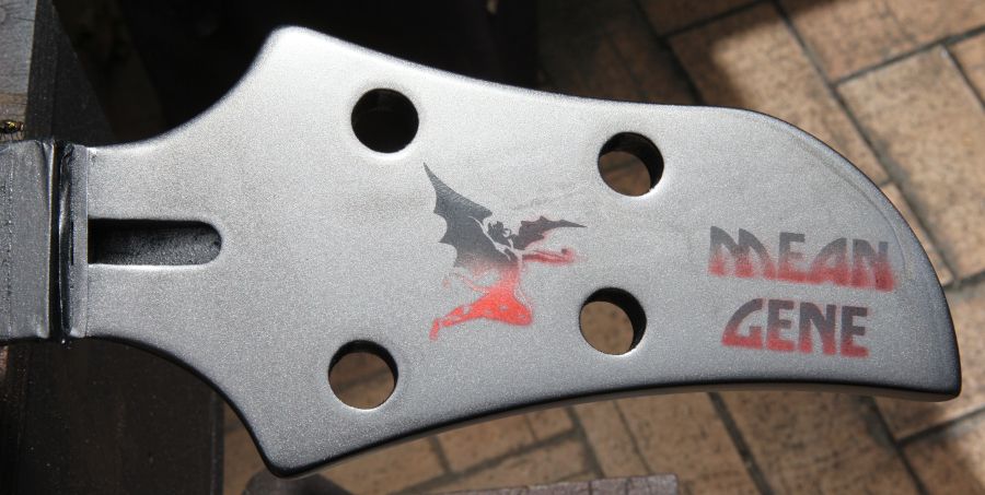

    Ok, so I sanded back, got some more stencil vinyl, and decided to have another crack. I managed to destroy yet another stencil when I tried to reposition it, but finaly managed to get it right. Unfortunately, I didn'y take my own advice, didn't spray some clear basecaut first to seal the edges, and ended up with bleed through between some of the letters :
    It looks a little weird because I was able to find the weeded letters and back masked them. I was happywith the way Henry had turned out, it was just the letters and I didn't want to sand and start *again* so I mixed some more of the charcoal base, held a card just off the surface and sprayed some light coats. The card off the edge masks off Henry whilst giving a soft edge that blends in with the previous basecoat. There was a chance that this could go wrong and the two coats didn't match and the edge still stood out. But they didn't. :
    I'm waiting for the clear to cure before flat sanding beause there is an edge around Henry. A bi product of my fix for the between letter bleed is that there is no edge on the letters.Because I didn't mask the tuner holes when I sprayed the base coat, the back of the headstock has a light dusting of metallic flake. I didn't think this was a bad thing, so I didn't try removing it before clearing. :

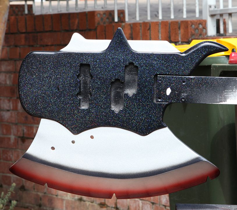

    I wanted to do a particular effect on the bevel. The paint has been around for a while by a number of manufactures. One thing they all have in common is they need to be done over a gloss black. This usually involves black base coat with polished catalysed clear coat. Some mobs brought out catalised gloss black . both required you to wait several days to cure before polishing and applying the overcoat. The stuff I used brought out a single stage gloss black specifically for it. But tried as I might I just could not get the stuff to come out glossy without it spitting, no matter what gun I used I kept having to sand smooth . In the end I had to resort to sanding smooth and spraying a coat of single stage gloss clear. Something like this:
    Then I find out that with the merging of the paint into another paint line, the tech sheet says to get the effect I was going for , gloss white was the way to go. even their own videos say gloss black .
    So anyway, I got the body painted and cleared, just need to flat sand and polish.Sorry Trevor, but I just had to show off....
    But credit where credit is due. I have a compressor, semi professional touch up guns, a professional airbrush, professional custom paint and several years experience with custom painting . All Trevor had to work with was a few rattle cans. His axe still turned out alright .
