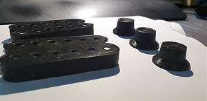

    In the interests of trying to keep my costs under control, I printed some stuff on the 3D printer:
    The humbucker covers are pretty fragile, but apparently should fit on with some effort. Not great, but that'll do until I get around to funding some new pickups in the Les Paul to swap.
    The knobs.. these ones go to 11. Pretty ugly on account of the printer but will be functional until I decide what I actually want to put on here.
  12. Liked by: OliSam
  13. #10
    Sand the tops down, fill in the knob numbers with paint and they should look fine.
