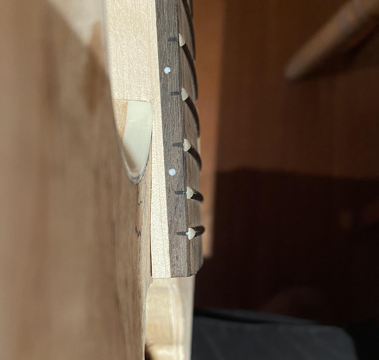

    Testing the neck out and having a closer look at it, looks like there has been some timber flake off in the routing process. Upon fitting, my rough sight notices that the angle isn’t affected but there is a small gap on the left side more so under the last fret so I’m not sure if it’s something to worry about now or just keep in mind later on for something. I understand that the pocket also needs a little tidy up too.

    I wouldn't worry about any minor gaps like the one in your picture below. It's very likely the gap will disappear when you clamp and glue it. If not, it's small enough for finish to cover and fill the gap:

    That neck heel area will need a bit of work. It's not great if you want to do an all-natural finish. I'd normally use a standard fine wood filler to plug any gaps like that after gluing the neck on. It's not in the most visible position, but you'll know it's there. I generally try and tint the filler with mixed-up artists acrylic paint to get close to the wood colour if I'm not doing a solid colour over the top. But it looks like you may have to do a small bit of sanding or chisel work to get the neck seated in the pocket properly, it seems to be sticking out by 1mm or so at the bottom.

    I think that once you have cleaned the neck pocket and pushed the neck home and clamped it then the bottom joint of the neck will also look fine. The binding needs a bit of a clean-up in that area as well.
