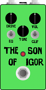

    Did the 3 knob 2 toggle drilling template in Inkscape, then added a first attempt mock layout:

    It's just an idea at this stage, trying to link the TS-808 heritage to the owner.

    Given that the EQ switch toggles between the stock TS mid-range hump and a flat response (a Jack Orman mod), I could label it "Hump". Open to other suggestions for control names.

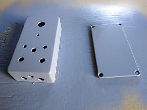

    I am still not fond of the pedal name, but that's not important right now. A little bit of progress today getting the enclosure drilled and primed. The new drilling templates I have made in Inkscape are working really well. As a result, these later enclosures are more accurate than the earlier builds this year where I was using generic templates off the internet.
