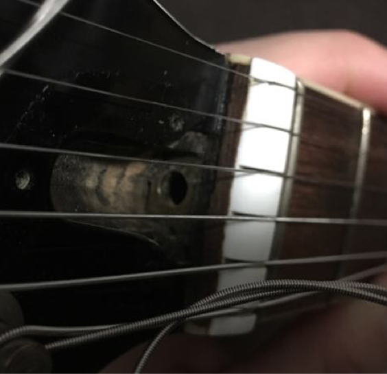

    It has a truss rod cover, which I believe makes it pre 1965, following which the adjustment moved to the opposite end of the neck. But how do you adjust it when the hole is round? I’m a little perplexed.
Name:	PNG image 46.png
    Some of those frets definitely look like they need replacing. I haven't done that job either yet, but a few guys on here have. Allegedly not as scary as it seems.
    Have you tried sticking an allen key in that hole? perhaps the rod adjustment itself is further in? or maybe its supposed to have a nut on top there? Might need to get the strings off and shine a light in there to see if there are any more clues.
    The nightmarish thought is that it was a traditional style, where there is a shaped washer under a nut, that is supposed to engage on a thread extending out of that hole. The middle type in the below:
Name:	type truss rod.jpg
    If that is the case, there should be something sticking out of that hole, which there is not, and your friend may have some bigger guitar related issues.
    I seriously hope its not that scenario.
