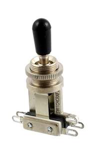

    I'd remove the existing 3-way switch so you can see what length of screw shaft you require on your switch. Gibson LP types normally have a reasonable thickness of wood for the shaft to pass through so have a long screw section, whereas if they are fitted on a pickguard then the shaft is much shorter. So make sure the switch is suitable for your needs. I find the 'open' type of switch much more reliable than the enclosed 'box' type.
    Realtone sell Allparts products, which themselves are normally major brand products. The Allparts pots are made by CTS. The Allparts branded toggleswitch is in fact a Switchcraft one. Here's a pic of one from the Allparts website and you can clearly see the Switchcraft name on it. Switchcraft are good.

    I tend to use Audio taper pots for everything, volume & tone, that way you can mix 'n' match without too much drama plus I prefer the smoother roll off on both. Bourns 500k push/pulls from Real Parts along with the switch above and 0.22 orange drops. Should probably go all the way and replace jack socket too with a USA built one. You will probably find the pot threads and jack socket thread diameter a bit larger and suggest using your drill in REVERSE to avoid tear-outs when enlarging the existing holes.
