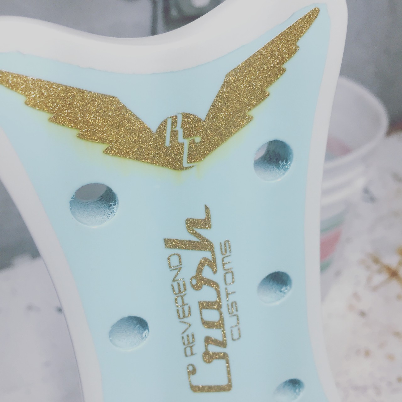

    PS- Here are a few pics of my build so far.
    Crash

    Hey Crash, does that need a home? Super work there man, great baby blue and shine for days. Top notch job Reverend!

    Lordy lordy lordy! Gorgeous paint work Crash!

    Thanks for the compliments on the finish guys. It was actually some leftover paint that my cousin had from painting the floor pans in a '56 Chevrolet Belair that he's restoring. I tinted it with a little bit of green to darken it the slightest bit and I was super pleased with how it came out.
