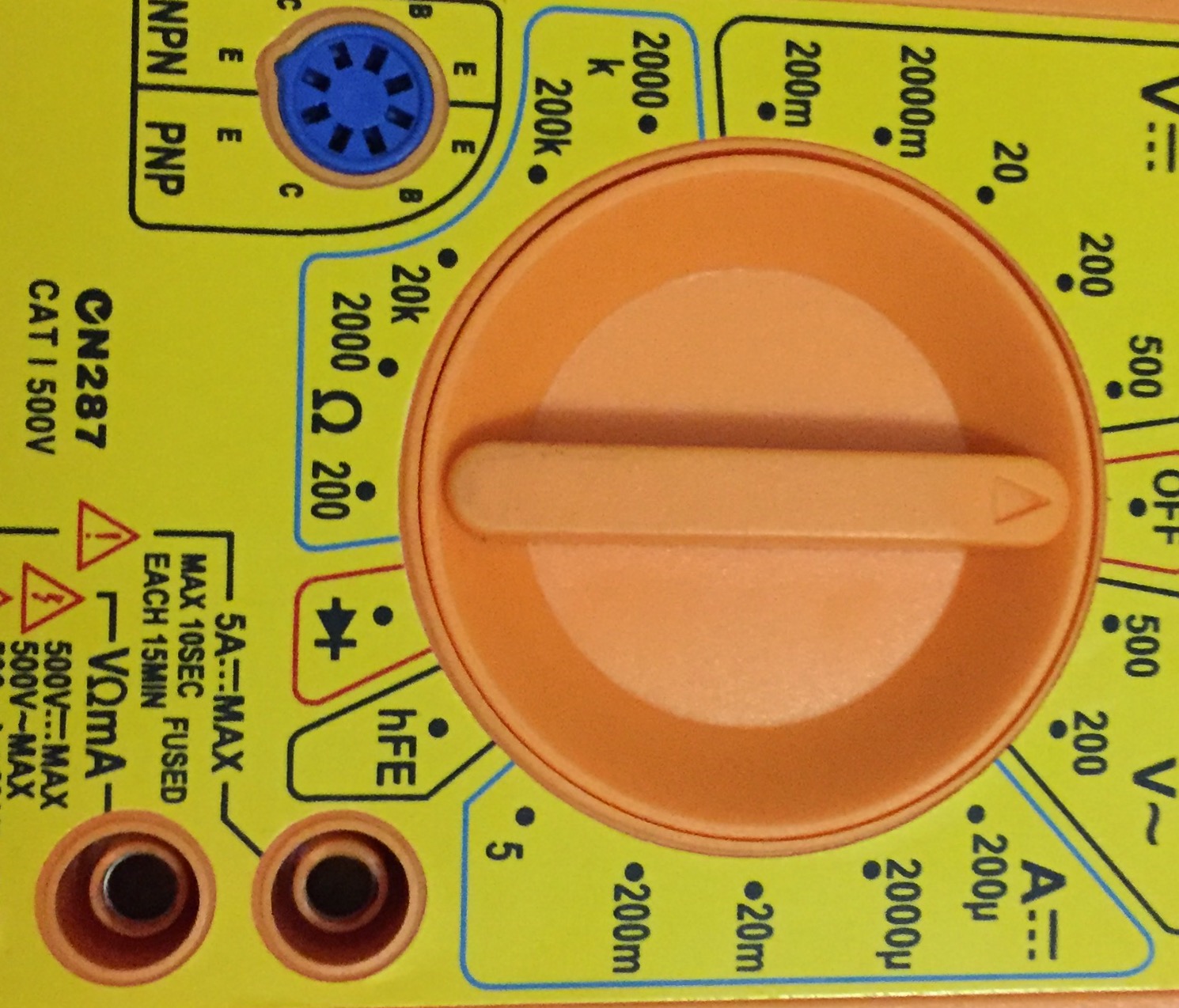

    Thanks for the response guys, I will put some pictures up shortly. The other pickups I used were from my epiphone lp. I have a multimeter but I don't know how to use it so advice on that would be helpful. Thanks.
    You'll want the multimeter on the resistance setting, but again, post a picture of your particular multimeter (they can vary a lot) and we'll help you set and use it.

ID:	18502 here is the multimeter, I was unable to add the pictures of the pots (I tried multiple times). Thanks.

    For checking good contact between wires, set the switch to the 6 o'clock position on the 200 ohm setting. There should be a black terminal for one of the probes to push into, the other should go in the one nearest the left in the picture with V(Ohm symbol)mA next to it. Then place the contacts on bare metal at two points you want to measure for continuity between and see what the reading says. It should be less than 1 ohm for a good contact or solder joint, and will probably read something like 0.03 ohms on the display. If it reads ---.- or 'over' (the display varies between makes), then the resistance between the two points is greater than 200 ohms. If you change the switch to the 2000k (2,000 kilohms/2 megohms) position and still reads 'over' or '---' then its an open circuit with no connection at all. If yoiu get a finite value, then it's either a high resistance joint, or there's a resistor in between the two points (it's going to be a potentiometer in this guitar-based instance).
    For checking pickup DC resistance, set the dial to the 20k ohm position. For checking pot values, set it to the 2000k position (the normal 250k and 500k values will be over the range of the 200k setting). If you get a low reading on the screen, then you can try turning the switch one click anti-clockwise to see if you can get a better resolution value.
