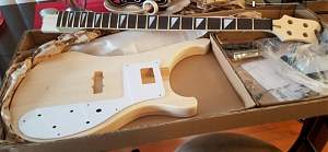

    Unboxing...
    Got my RC-4 kit from Pitbull...everything looks great. My first try at building one of these kits...
    The things I am going to do to this bass.
