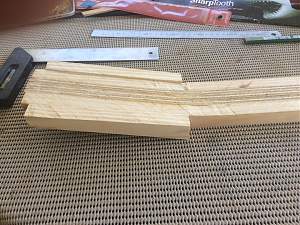

    Cut the pine and the ply.
    I thought it would be easier to give the individual pieces a rough shape before gluing. It also gave me the opportunity so rebate the centre strip of ply for the truss rod channel.

    Looking good.
    I'm a bit surprised that you're putting a truss-rod in, another classical no-go area like bolt-on necks. As classical necks are normally wider, thicker and the nylon strings have far less tension than on steel stringed guitars, they don't really need a truss rod. Of course it will work, but you'll probably find that the neck just stays flat without needing to tension it at all.

    @Simon
    Thanks Simon, the truss rod is a bit of the belt and braces approach. It’s there if I need it, but I hope I won’t. Being pine I thought I would play it safe as it’s not the most stable of woods.
