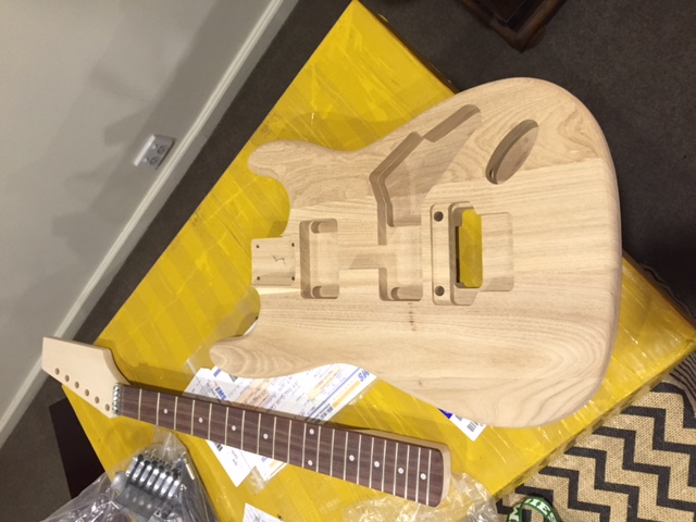

    So first step I ordered a STA-1 guitar but decided I wanted to go down the super strat route thus got a custom order with only 2 humbucker routes and also routing for a Floyd Rose trem , the guys quoted me about 6 weeks for delivery and it turned up in 5 = me stoked

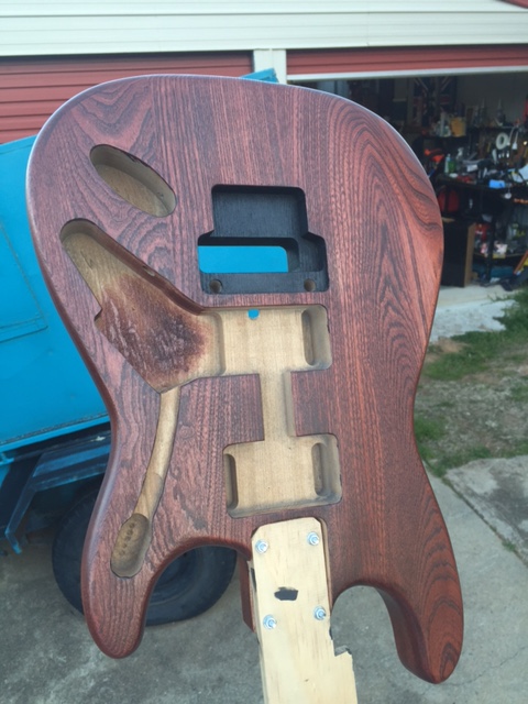

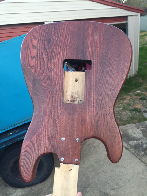

    So I used Brown Walnut Colourwood interior stain from bunnings , I have actually already used this before on a re-housed amp head and I liked the colour as it had a bit of a red tinge to it and I already had a tin of it so thought lets give it a go and it came up looking really good i think

    One thing I found out after I stained it was that if I wanted it 100% smooth I should have had a second go at grain filling or applied a sanding sealer but I ended up really liking the look and feel of the little bit of texture the ash grain gave it and as I was not going to be doing a gloss finish instead opting for a satin finish I moved onto the lacquer stage
    As i haven't any experience with spray guns I opted for the spray can variety, I bought a can of the Behlen jet spray clear nitro satin from guitaraust.com.au
    Its pretty cool this time of year in Canberra so I had to wait for a warmish day to start spraying but started off with 3 x light coats on the first day with a couple of hours drying in between each coat, i have a small music studio in my garage which provided a nice place to keep it safe from the elements and dust for drying. the next coats I did only one a day as I was limited by time and temperature and so by the end of this process I have applied 6 coats all up to the body and 5 to the neck (which i forgot to mention I had also stained but as it was maple I had to stain it twice to get the darkness to match better the ash body).
    So I am now about a week away from assembly as I await the nitro some more time to cure thus I will chime back in with an update next week and hopefully an assembled guitar!
