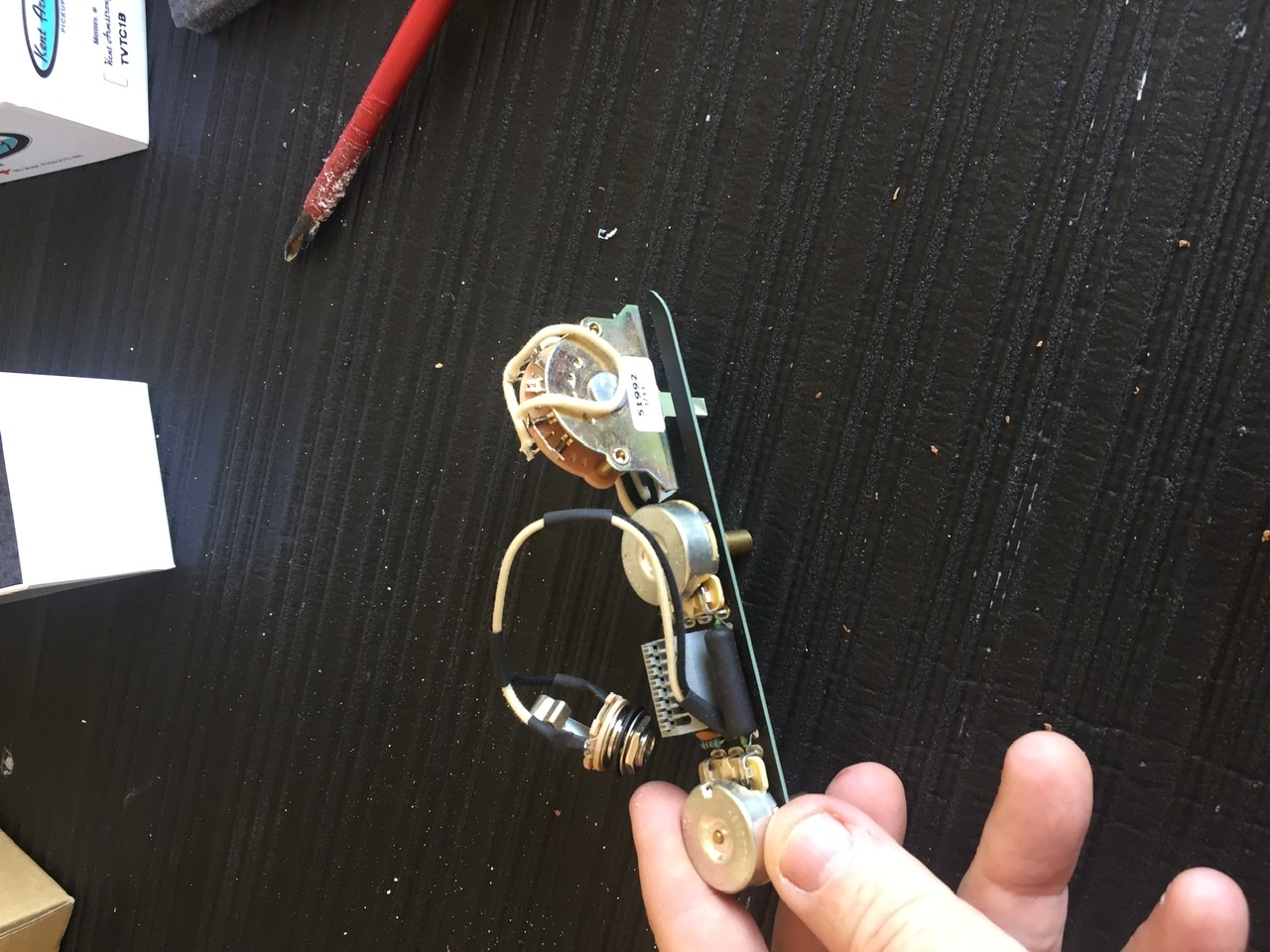

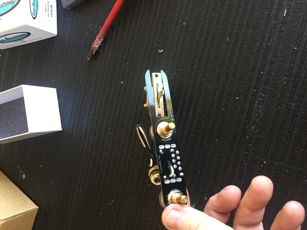

    Hi have used the obsidian stuff. Got a set of Tele controls to see how they were. Found them to be good quality and the non solder pickup connections were very solid compared to what I was expecting.

    Quote Originally Posted by vh2580 View Post
    Thanks Tony, for the pics, they good good, nice simple and clean. I had s bit of a look on YouTube and one of the guys doing a review made it sound pretty easy to remove a pot if it was faulty. Looks to be a popular choice for the Gibson LP to replace that harness they were using.
