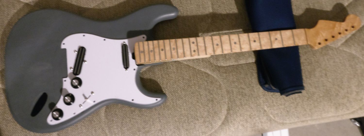

    Bit fuzzy...light was not good... but here's how it lays out at the moment:

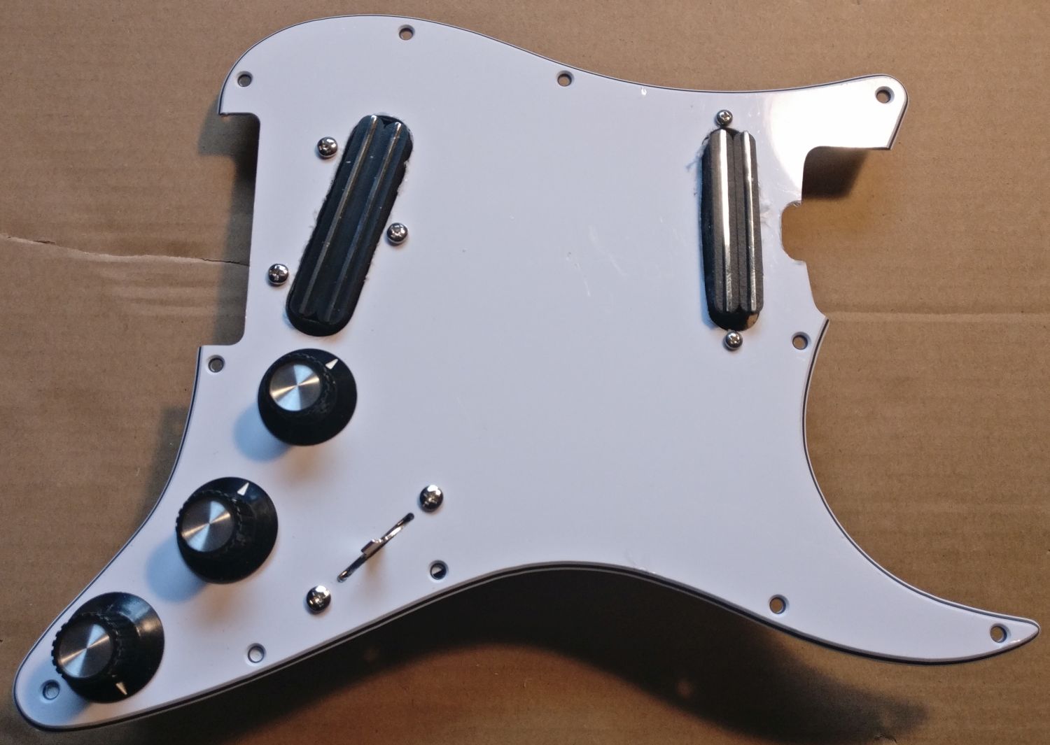

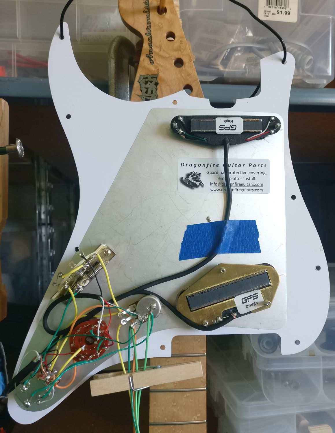

    Bought a Dragonfire custom pickguard from TNT Custom Guitars in Klamath Falls, Oregon. They were a pleasure to deal with, and the pickguard fits beautifully. Much easier and more pleasant to deal with than the time I bought a pickguard from Warmoth...

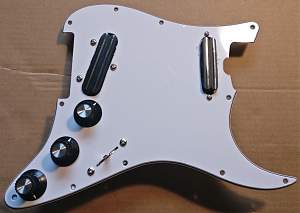

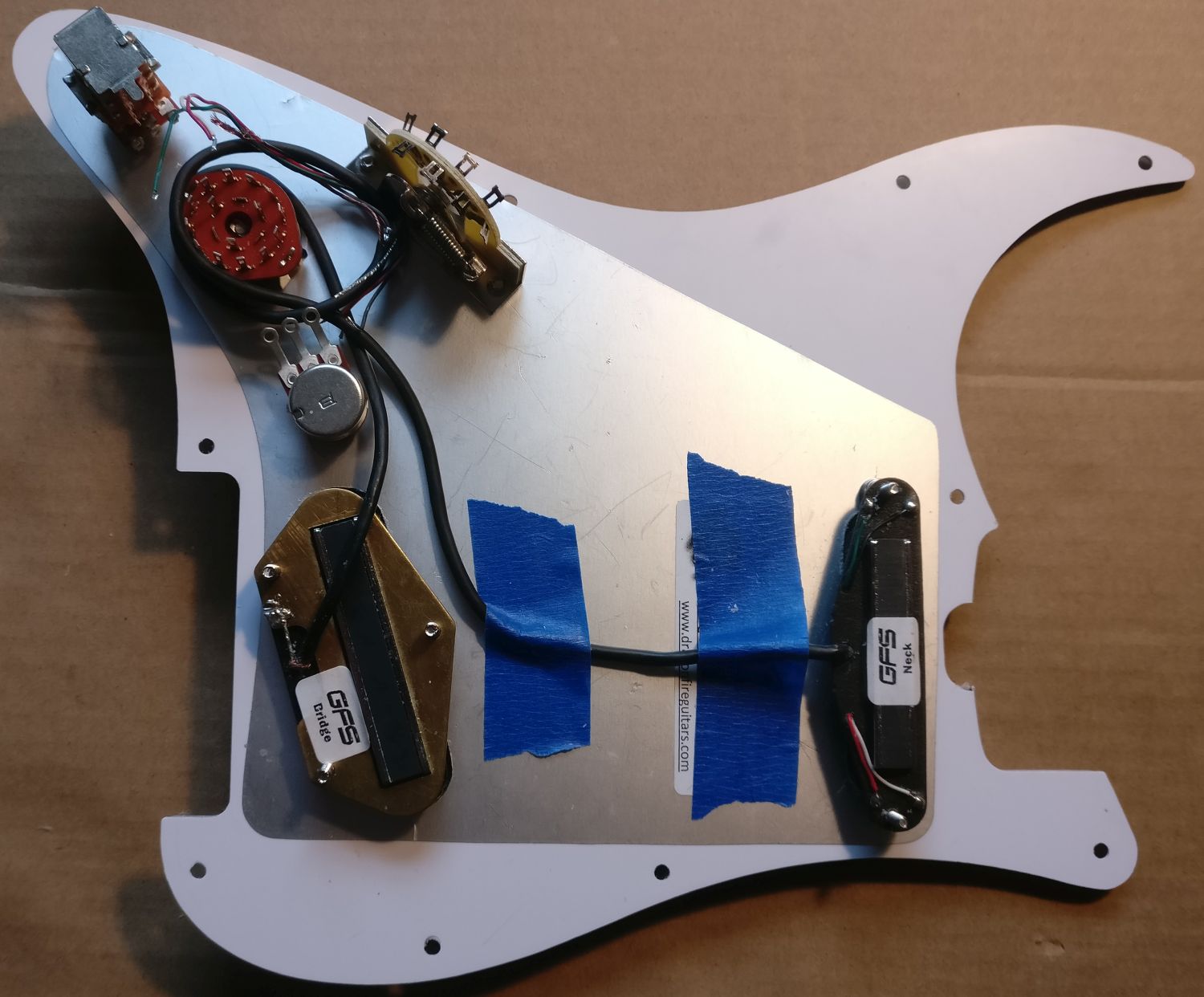

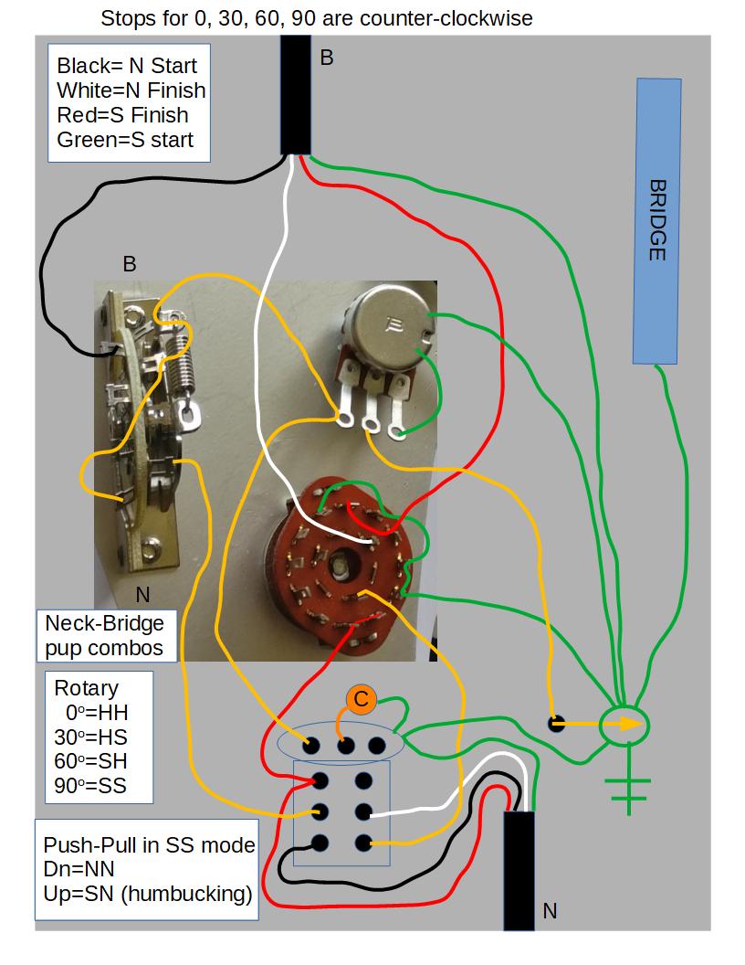

    I could not decide on switching so, decided to just go for broke. I haven't wired it up yet, but I have the parts...
    Top pot is Volume. Bottom pot is a Tone with a push pull switch. In the middle position is a four-way rotary switch.
    The rotary switch will switch humbucking and single coil modes. HH, HS, SH and SS. The SS setting from the switch is traditional Tele, so it is not humbucking because it uses the north coil of both pickups. The push-pull switches from the north to the south coil on one of the pickups to make the SS setting humbucking. Probably more trouble than it's worth...but thank you to WeirdBits for helping me to map it out.

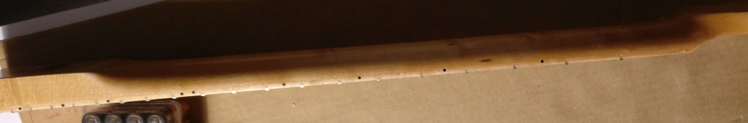

    So far the only other thing i have done...today...was to add fret marker dots. The build is right-handed, but the neck was intended for lefties, so it has dots on the wrong side for me. Followed the Dan Erlewine method from YouTube as best I could... Here's the result:

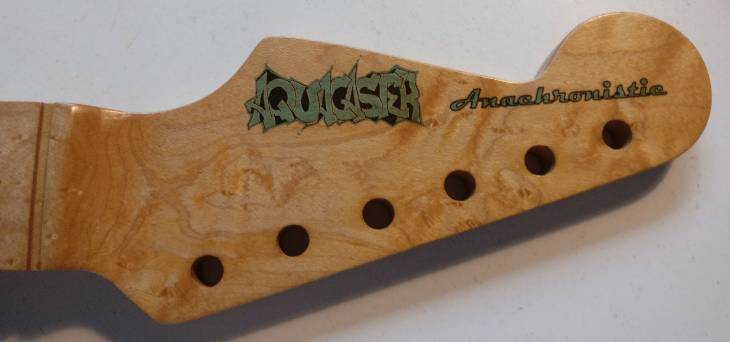

    My daughter created the logo. She is becoming quite the graffiti artist. Wanted something to go with the planned sea foam green-ish body color that my son picked out. So the "Aquacaster" is born...or at least gestating.
    Still ruminating about neck finish. The neck is basically finished and looks pretty good other than about three spots that are bare due to some sanding. Maybe s tad thin where I added side dots, and of course I need to cover the logo. Is there any reason I would need to use more than shellac on it? The places that are thin are not in places that will get much wear....Click image for larger version.

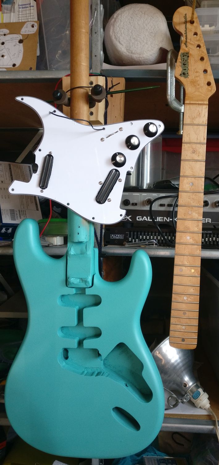

    This may be progress...will depend on what it looks like after a little sanding. Used the trusty MTN94 rattle cans to put 5 coats of "Bali Green" ...sort of like one of the Fender surf colors... over the automotive primer that's been on this beast for years.
    I *think* I have most of the parts, so I decided to work on the finish.

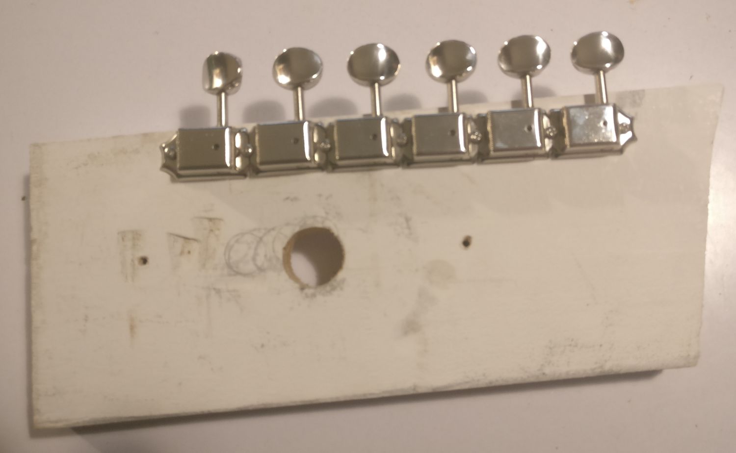

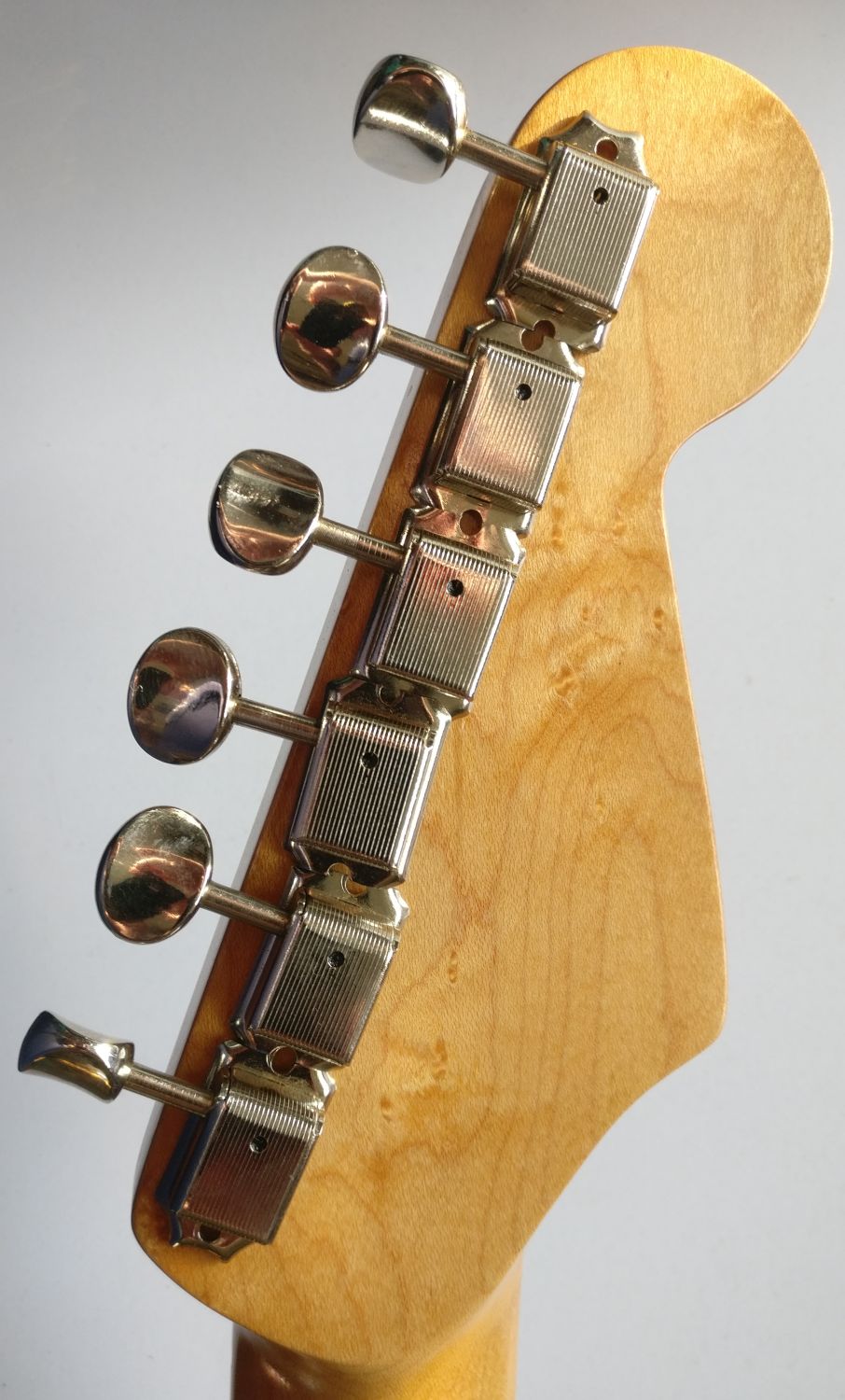

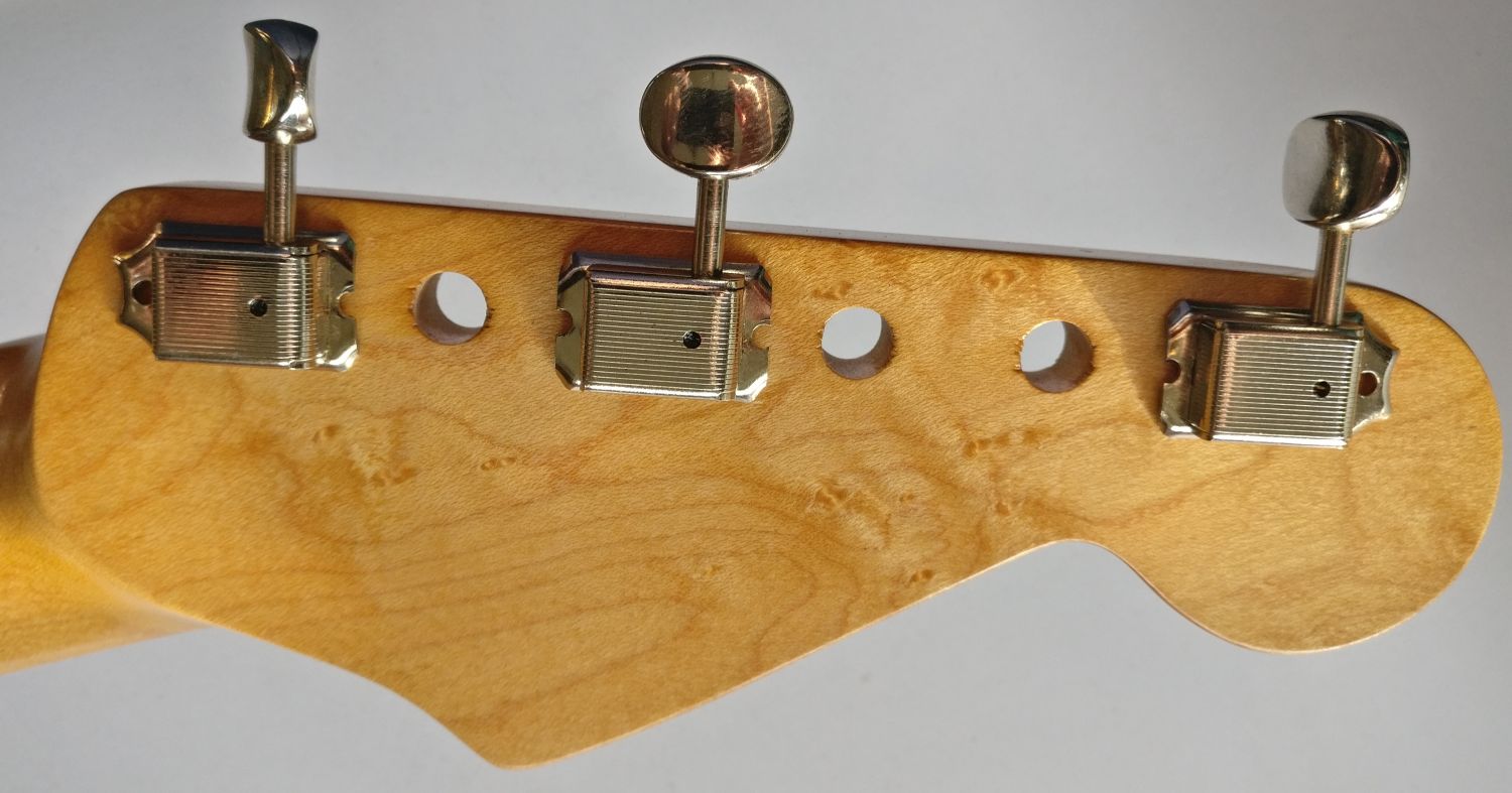

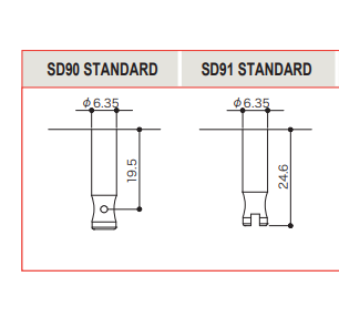

    Probably getting ahead of myself here since I haven't put the final clear coat on the neck yet...but I have a question about how to mount the tuning machines.
    I think I mistakenly said their were Klusons above. They are actually Gotoh's. Clearly there is one for the right side, one for the left, and the rest to go in the middle...
    Unfortunately, no matter how I arrange them, I can't get them to sit flat when I put them all in a line...

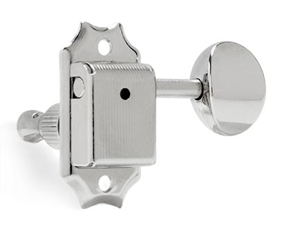

    Has anyone had some experience with these. What it looks like is that they were all once like this...
    ...but got trimmed without a lot of precision.
    I am thinking that once I install the ferrules I will need to file the interlocking ends down so that they fit. Is that how this is generally done? Is there a better way to trim the ends? Do they usually fit perfectly and I just get a crappy set. Wait! Don't answer that. One thing is sure. I got them so long ago, I won't be able to return them.
    However I do this, should they overlap at all? or should they be flush with each other?
    I've had some similar vintage style tuners.
    Trouble is that the spacing of the holes are critical to get a good fit.
    I would suggest grinding the edges of the middle tuners to get them fitting together.
    cheers, Mark.
    Hey fender3x.
    The single tuner in the photo you posted is from a 3 x 3 set. It has the full "ears" and is fixed with 2 screws per tuner.
    The ones you have are made to interlock using 1 screw between each tuner like king casey's pic.
    Warmoth is generally very good with their products (even in the 80's) but it would be worth measuring the tuner hole centres just to be sure. If they're mis-spaced, it may require some plugging and re-drilling to get a good equal fit. If it were me, I wouldn't trim the tuner/s.
    I used a set of Gotoh Kluson-style tuners on my PBG TL kit, but had the opposite issue. The holes were too far apart. I ended up fashioning small "washers" to bridge the gap between the tuners.for the fixing screws. Not my best solution, but it worked. Good tuners though.

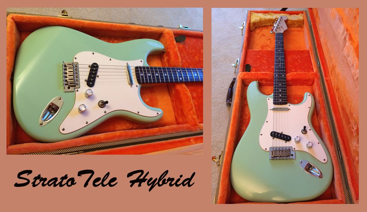

    Just for fun, I've posted one of my Strato-Tele below.
Name:	Strato Tele 20pc.jpg

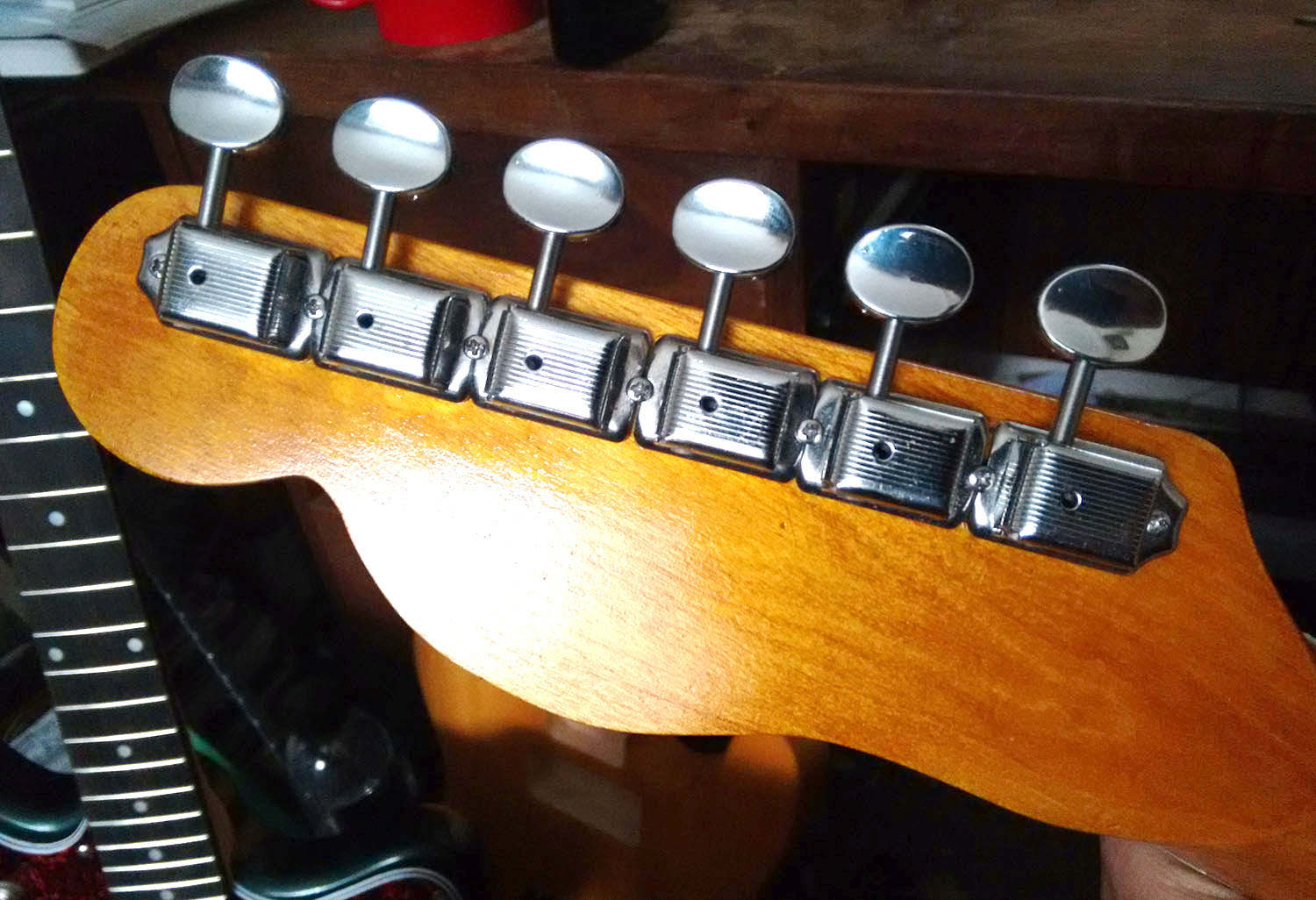

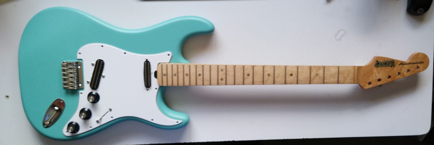

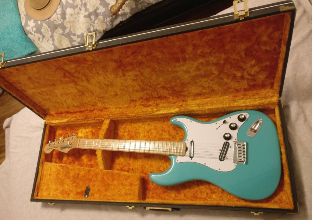

    Did an initial setup. The serrated feeler gauges work to make the nut slots, but are slow. Took me two days working a little at a time. Still need to sand down the top of the nut, polish and glue it. That said the guitar is playable and I could not resist the pic.
    Couldn't resist taking a pic, tho. I had purchased the paint before seeing the "Stato Tele". I got the case for it in 1987. So the similarities are coincidental, if striking

    The middle ones I have appear to be cut. The are not uniform for one thing. I'll check the hole spacing, but I can say for sure that the tabs are not uniform. They look like they began life as three-a-side and were just cut down to (almost) fit. But why would anyone do that if you can buy them to fit? Very strange.
    I may be forced to grind or file, as King suggested.
