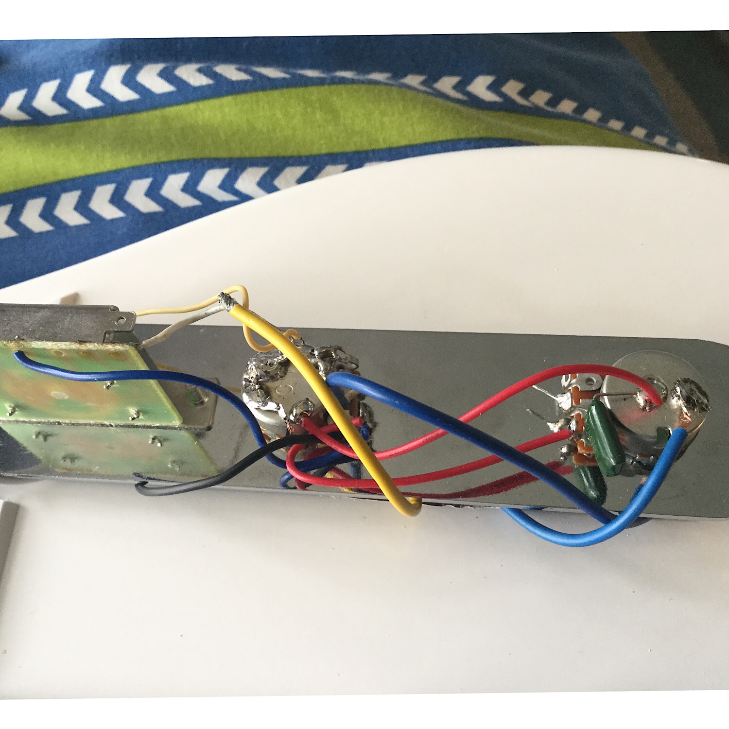

    I’m building a TL-1 kit and have seem to run into a problem with the electronics.
    Once I soldered it all and assembled with strings, I plugged it in to test it. The moment I touched the strings, it buzzes. It sounds just like the standard electrical hum but it is much louder. It buzzes when I touch the strings, bridge and control panel (except when I touch the knobs).
    Here’s some pictures of the wiring (there are extra wires as we grounded the bridge and the switch/control panel, which is the little brass bit, to the pots)

    Can anyone see any errors or problems? All the bits came from pitbull but it still could be the bits.

    Hi mate. It's an earth problem in one or two places. First, check the bridge earth for a good, clean contact. Second, copper tape the back of the control panel and control cavity so that the tape touches and completely shields the electronics. Don't let the screws touch the tape though. Did you tape the pickup cavities too? See how that goes then check for any dodgy earth connections elsewhere. Hope it helps.

    I think this happened and it was the positive and earth leads arse-about on the input jack.

    The fact that it's buzzing when the strings are touched (not the other way around) sounds like a reverse ground.
    Have you checked that the input jack isn't wired backwards?
    TBH, I'm having difficulty tracing exactly where the wires come from and where they're going in those photos. This kind of issue can also be caused by a cold solder joint (not fully soldered/connected) and they can be practically invisible to the naked eye, but wreak havoc with a signal path.
    I would suggest checking the input jack first and, at the risk of sounding like an a-hole, some of those solder joins could stand redoing. Possibly de-soldering/re-soldering everything just be sure.
    If you have a multimeter (a wise investment if you don't) continuity check each connection as you go and keep testing ground.

    Thanks to everyone for the tips, before eating dinner I re-soldered everything over (don’t worry McCreed, no a-hole vibes) but that didn’t fix it so after I switched the jack wires.
    This seems to have fixed it. No extra noise when touching the bridge or control panel.
