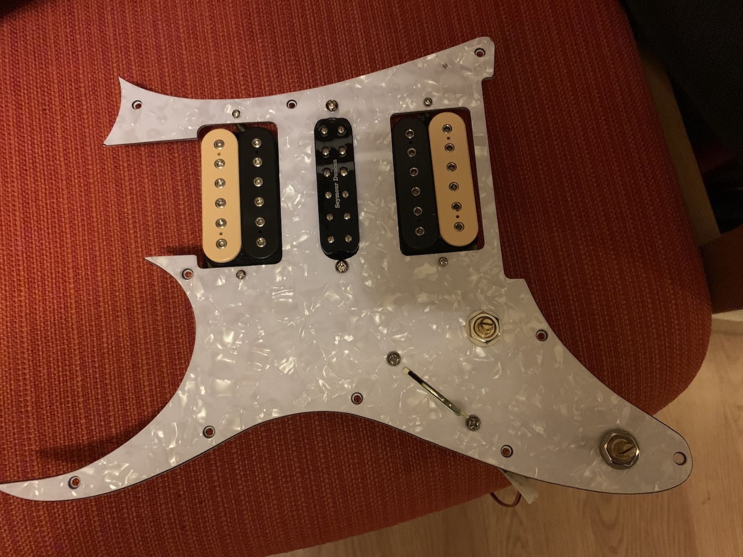

    Schaller tremolo, Dimarzio super distortion in bridge, humbucker from hell in neck and a Seymor Duncan JBJR2 in the middle. CTC pots and Dimarzio 5way switch. In a couple of days pics will come as I put paint on it now, pearl white.

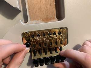

    Slowly making some progress here, vill fit bridge next and then try to get the neck in the right spot.
    Hi piece,
    I measured up mine as below tonight.
    The neck joins the body at the 18th fret at the upper cutaway and at the 20th/ 21st at the bottom.
    As near as I can measure it with steel rules, the end of fretboard is 139mm from the centre of the bridge anchors.
    I’ve not done a huge amount of work on intonation with this one but it all plays pretty well and rings true.
    A word of caution, I notice you have the I company logo on your headstock. Your finish looks great, but if you don’t want admins to delete your photos, edit out the logo, or cover it for your build diary shots.
    PBG are very supportive of the build community, but trademark logos etc are a no no for the posts.
    Hope this all helps,

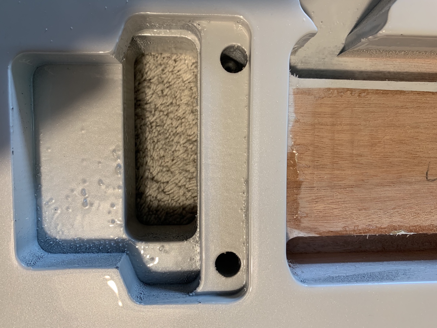

    This is kind of bad, missaligned holes for the brige make it look... Hrm not so good. Annoying i would say.
    Any ideas if something can be done to make it look better?

    Not a lot you can do with that now the finish is on.
    The fix would have been to plug these and mark out for re-drill based on a standard length, see the attached link to the stew Mac calculator, it will give you the required distance from nut for these stud positions.
    https://www.stewmac.com/FretCalculator
    Enter the values for 647.7mm scale length and 24 Frets and you can check how far out it is.
    Have you reshaped the neck profile? It looks fantastic, really excellent work mate, well done!!

    I guess its possible to redrill, if i could get the poles out again. Any ideas how to do that?
    Did little reshape on neck yes.
    Going to put it all together to decide if it plays and sound well enough to bother about the bridge.
