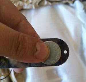

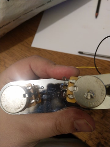

    Hi Colin,
    I'll have the same issue as you. If you don't want to modify the cavity and the backplate you'll have to buy mini-pots (pots with the same size as the ones that come with the kit). Or else, you'll have to remove at least 1 milimeter from each side, except the in the curves. Also enlarge the holes on the backplate.
ID:	34222 Click image for larger version.
