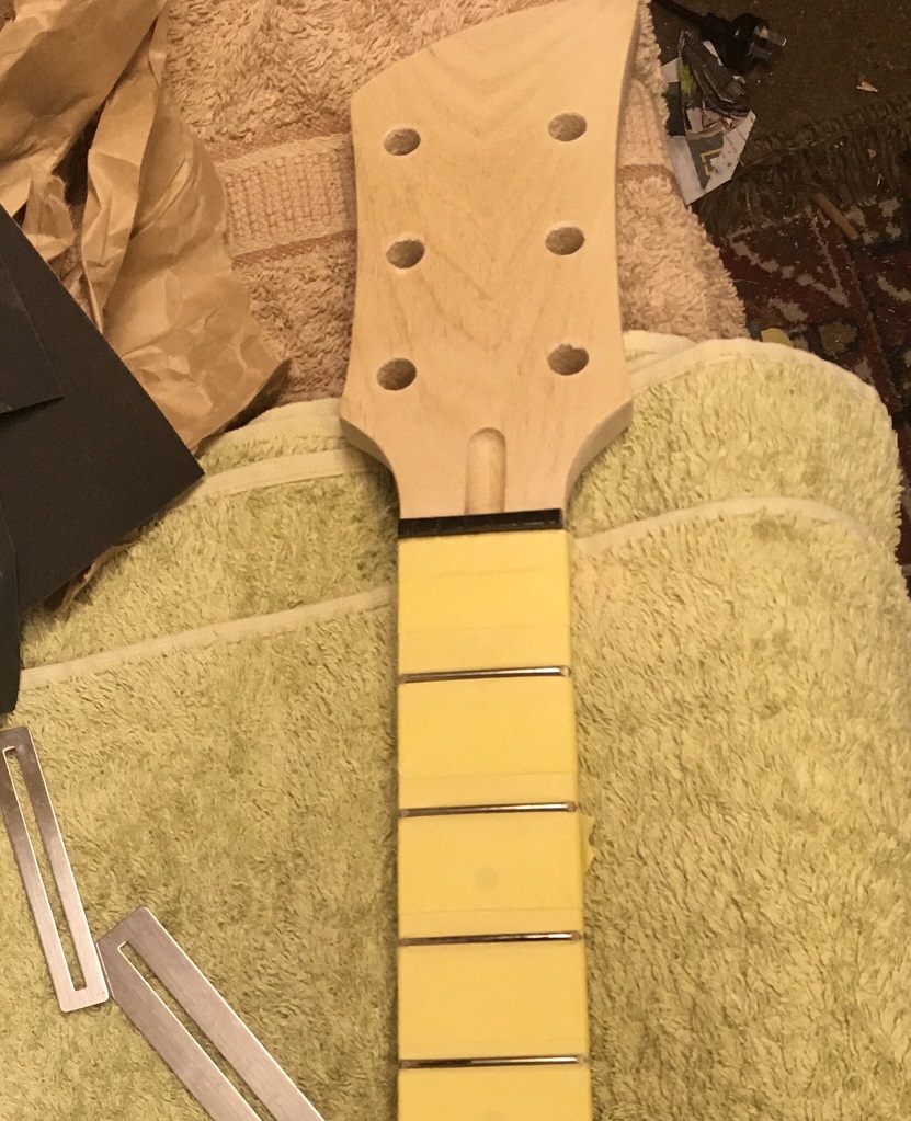

    Headstock shaping completed. Surprise, I've gone for a pseudo ricky look.
    I also did a full fret level with 400 grit...next is fret crowning
