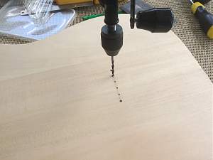

    Once you have located the bridge correctly its time to drill the holes for the string-through bridge. As with all my builds I will not be using any power tools, only my trusty old hand tools.
    So with the Bridge located exactly I use it as template to mark the string-through holes on the upper body.
    The top of the guitar. I start with a fine Brad Point Bit for its accuracy and then drill a hole about half way through the body with a regular bit. The tricky part is to drill the 2 outer holes all the way through the body. Make sure the drill is as vertical as possible. This is where a hand drill is preferable to a power drill as a hand drill does not “get away” from you like a power drill. Ask me how I know??

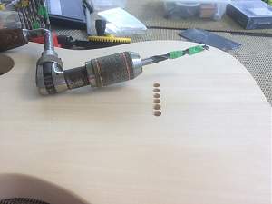

    The back of the guitar. This is the important part. With the 2 outer holes already drilled through to the back, all you have to do now is space out the remaining 4 holes and drill them though until they meet up with the holes you previously drilled through the front. They don't have to line up perfectly with the holes from the front but as long as they are spaced out fairly evenly they should look OK.
    Obviously the holes in the back are larger as they have to take the string ferrules, so I find a Brace and Bit is a better way
    to drill these holes.

    Definitely not as accurate and pretty as a drill press, but you have to make do with the tools you’ve got. Seeing as this guitar is being painted the minor tear-outs can be fixed with a bit of putty before painting.

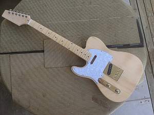

    The rest is pretty straight forward and before you know it the Dummy Build is complete with everything screwed in place, for now.

    Good to see you back Robin, a bit of honest toil is an excellent dog tamer and well done your mate for being there.
    As per many tuits on YouTube I use the bridge as the template for the string through holes, I the top holes as you have but only put outer holes right through as guide holes and then drop a couple of small pop rivets in which the bridge sits nice and snug on and the do the final through drilling of the other 4 holes

    Thanks mate. Yeah, about time I kicked that damn mutt out of here. And you're right about good friends, sometimes they have no idea how much they help.
    Good tip with the pop rivets, never even thought about positioning the bridge on the back of the guitar. I must like doing things the hard way. lol.
