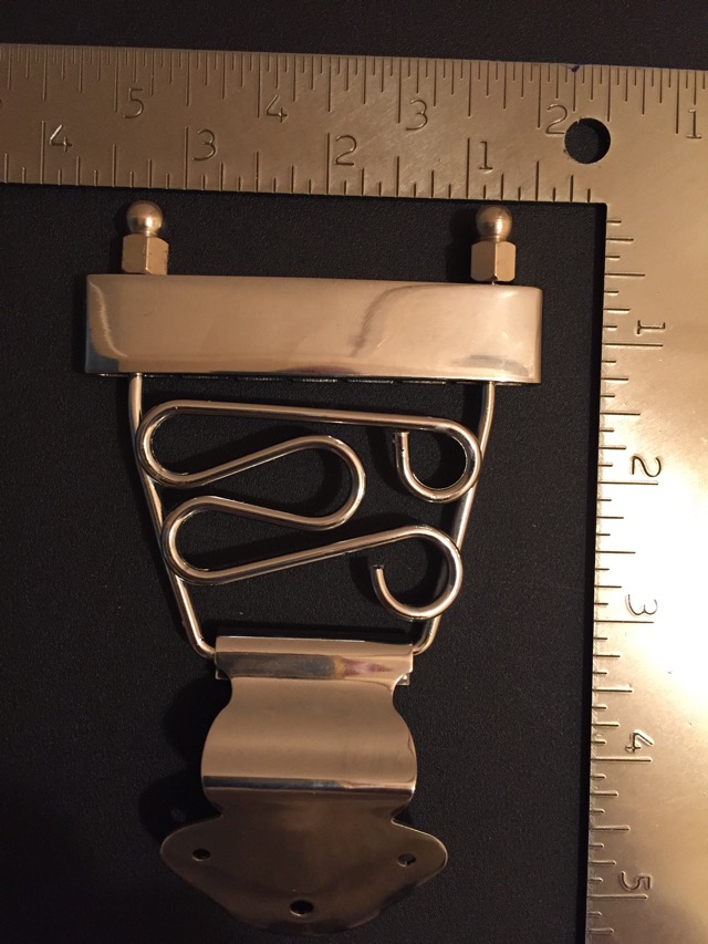

    Is my Trapeze tailpiece correct, because it looks crooked to me. I tried a mock build and had a few problems. The high e was too close to the edge. The string height was about 1/4 inch at the 22nd fret. I could not keep either string in the saddles. I think it’s because of the trapeze. I’m attaching some pictures...
    In the 1st pic, it is hard to see, but the left post is pointed down and to the right. The 2nd pic shows how twisted the posts are. The 3rd, though nhard to see, shows how close high e is to the end of the fret board.
    What am I missing and/ or doing wrong.

    I have played around with these for bass... Can you bend the rods into the position you want? I have done that with these. The trick is not to be d so much that you weaken the metal, but I found it pretty forgiving.
    One side is often a little shorter than the other. You can adjust with the nuts. Once the guitar is strung, the tension will keep the but from loosening.

    Thanks, will try to carefully adjust.
