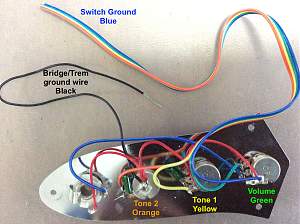

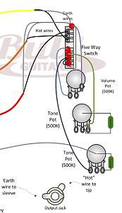

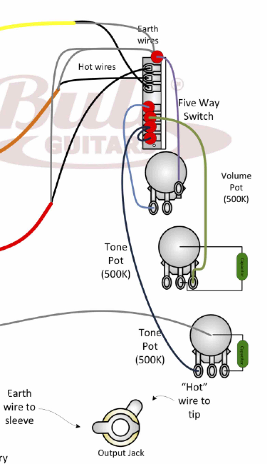

    Help needed re JMA-6 baritone wiring ..... When I look at the wiring diagram I received after emailing Pit Bull, I'm just confused! (I'm an experienced muso, but a total 100% novice when it comes to guitar builds, and I'm afraid even stuff the rest of you guys can do in your sleep has me stumped.) The diagram Pit Bull sent me looks like this .....
Name:	Pit Bull JMA-6 Wiring Diagram.jpg

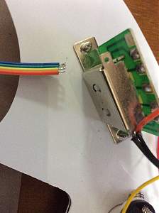

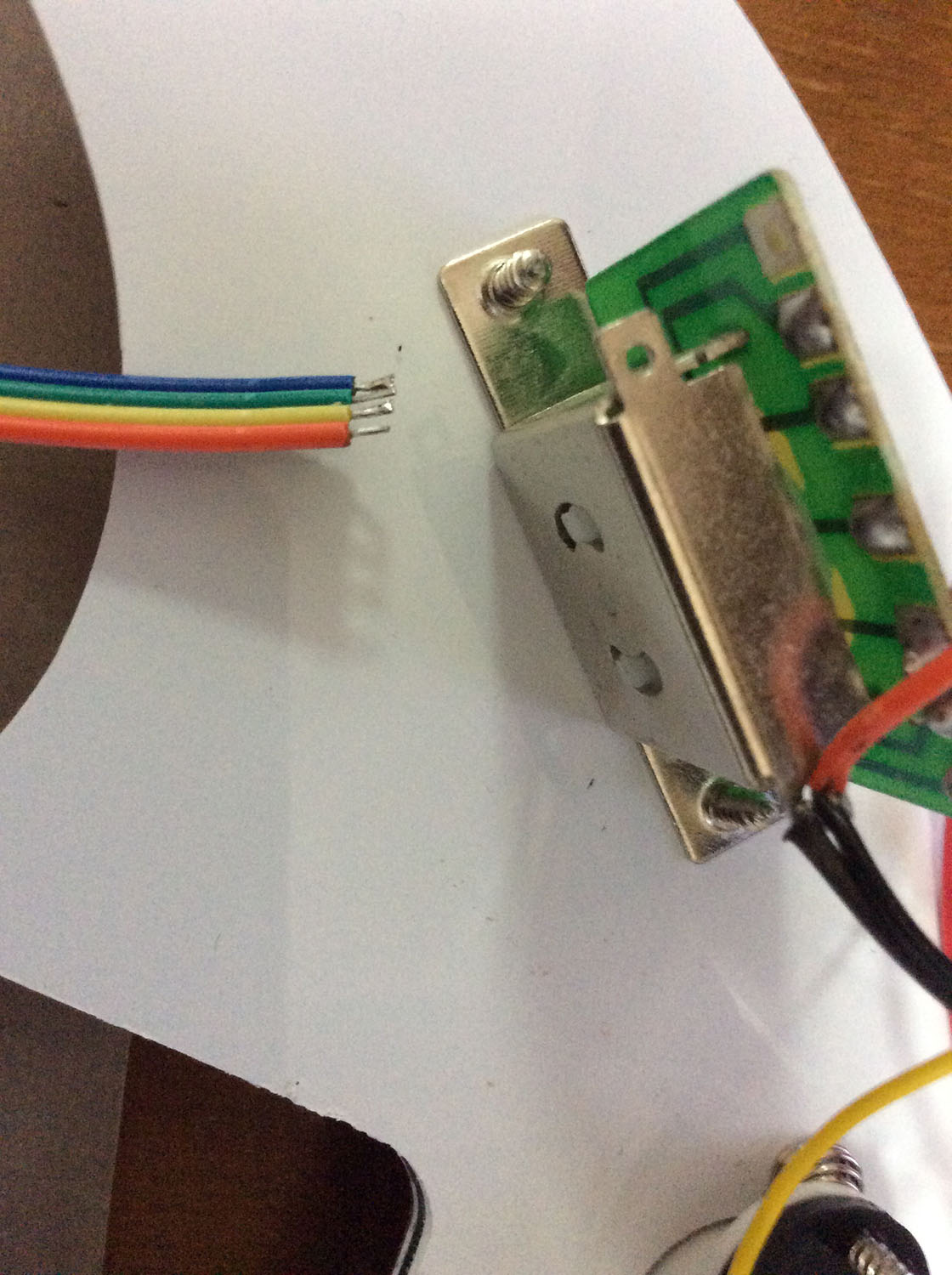

    My dumb interpretation of that is that multiple wires need soldering to the five-way switch. However, when I look at the five-way switch itself and the wires coming from the pots (see photo) .....
Name:	JMA-6 Actual Wiring.JPG
    there seems to be no place to solder multiple wires, so what do I do with the four coloured wires coming off the pots (aside from the ground wire, of course, which I do understand). Now, I realise that this discrepancy between the Pit Bull diagram and the actual set-up is undoubtedly because there's pre-wiring already done on this kit, but that doesn't help me when it comes to knowing how to complete the task. What do I do with those four coloured wires as shown in the photo? Where does each get soldered? ..... Again, my apologies for the very basic nature of this question, but, never having build a kit before, I don't want to experiment — I want to get it right. Thanks for any help that anyone can offer!

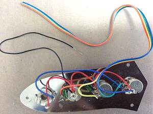

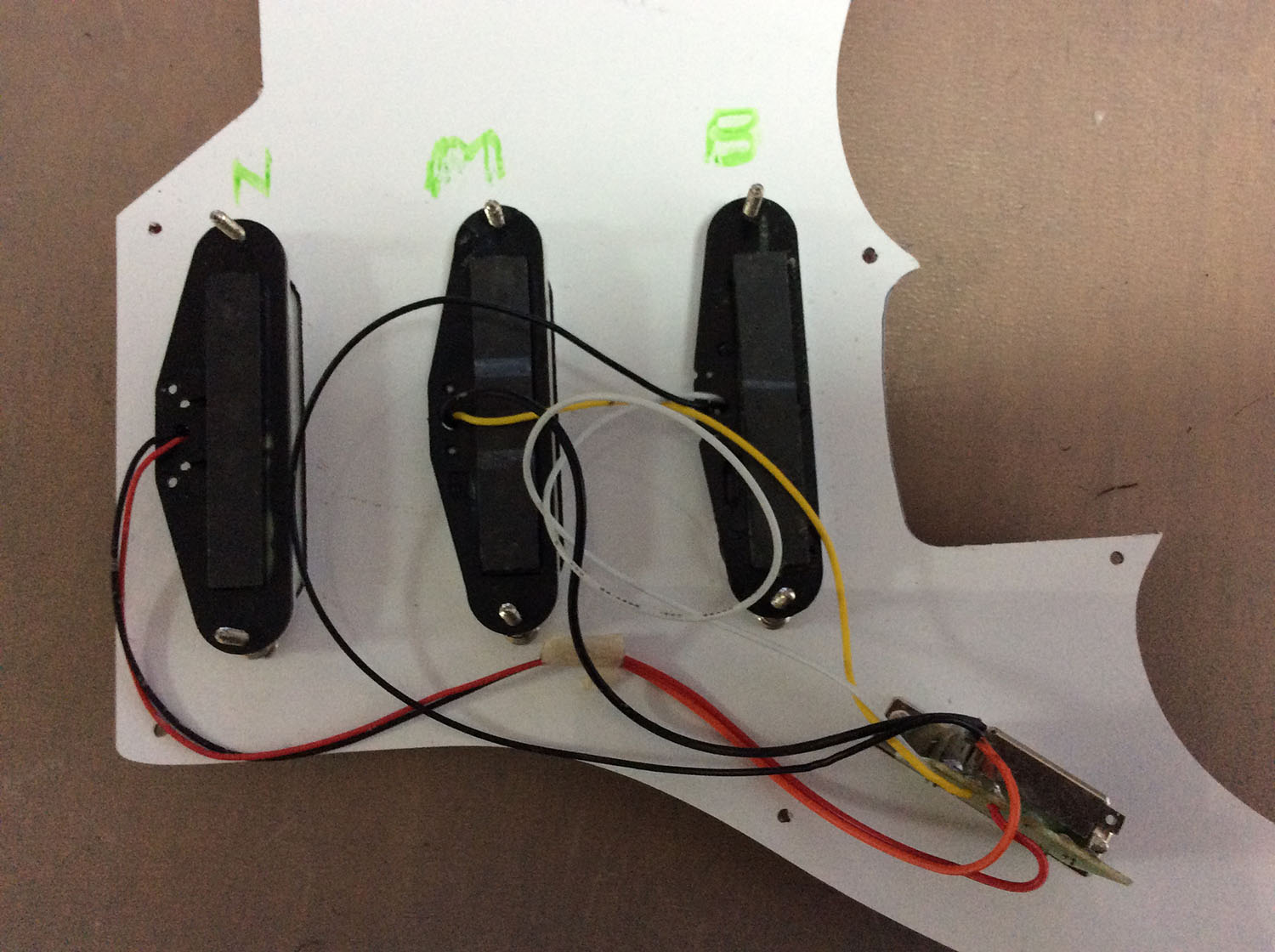

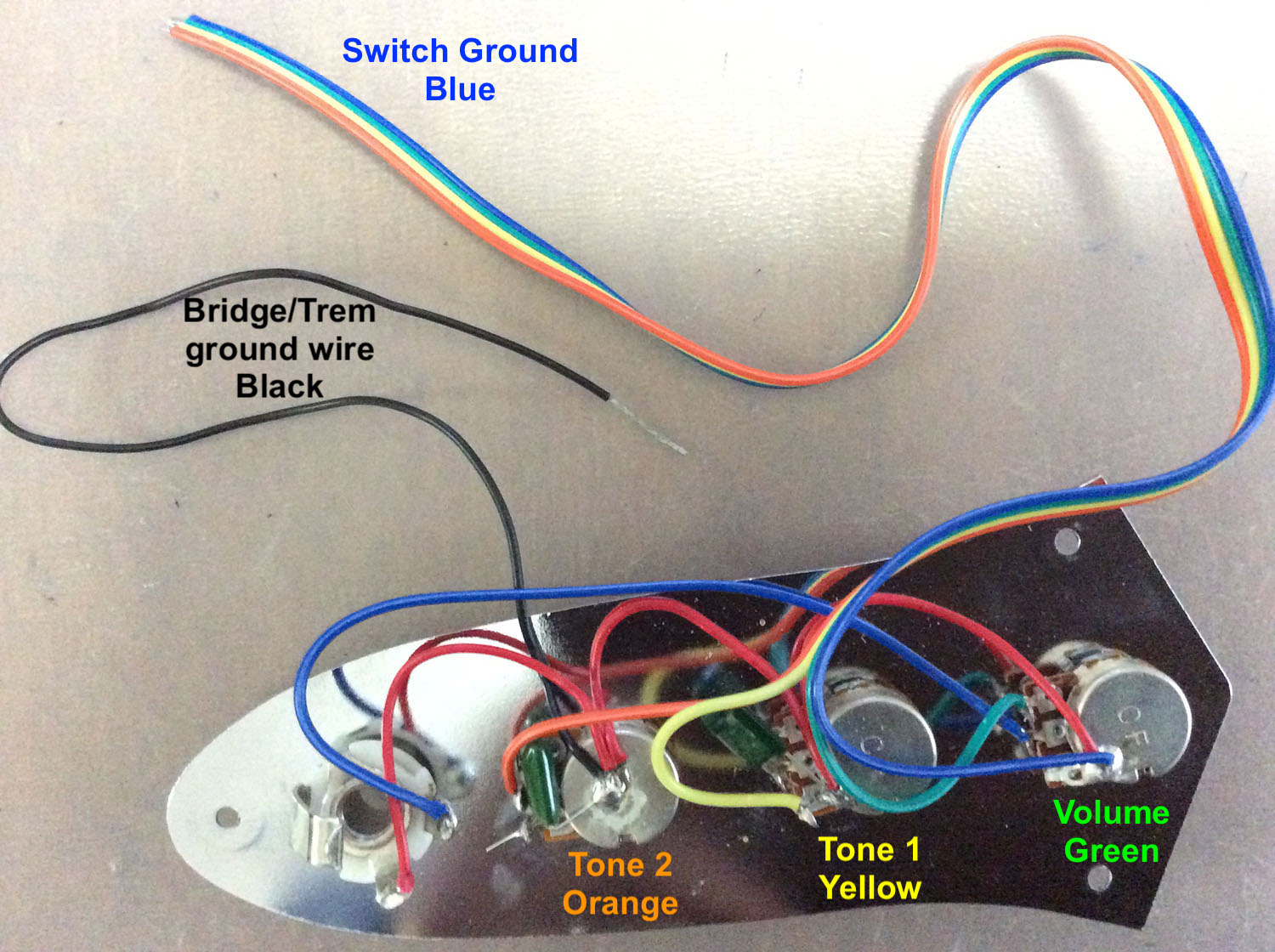

    Thanks for that advice, colin2121. Have uploaded two more pix of the wiring as suggested .....
Name:	Pot wiring.JPG
Name:	Pickup wiring.JPG
    The multi core wire is just for convenience. You separate them like string cheese.
    The PB diagram usually only shows the wires and solder points you need to worry about and omits anything pre soldered/wired.
    So current is generated in the pickups by the guitar string vibrating through the magnetic field. This induces a current in the coil which is sent out via the 'hot' wires. Everything after that is managing the flow to the jack. So current goes in one side of the switch and comes out the other and onto the pots, then the output jack. There is more than one way to manage the current flow and it can give different results, but the diagram should cover the most common routing.
    More pics would be helpful so we can see what's already done and as Col mentioned Wierdbits is far and away the most helpful person to talk to regarding this stuff.
    I’ll mark up the connections for you when I get some time a bit later today.

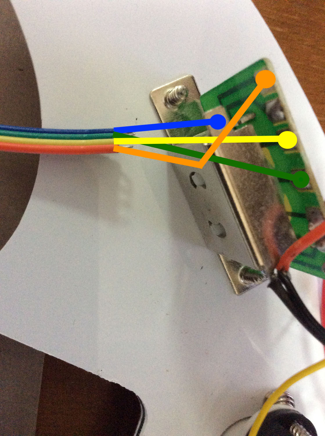

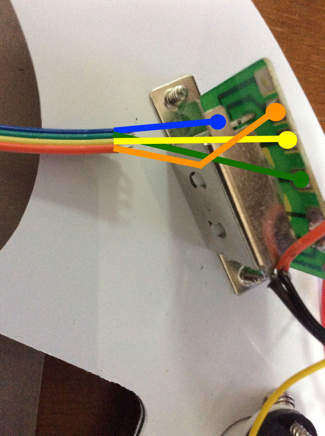

    Thank you so much. All I'm looking for is something that says "Solder the green wire to Contact X" etc. Pit Bull initially told me there was a video covering it, but it turns out that, because the JMA-6 Baritone is a new kit, there's not. I'm a muso, not a techo, so I really do appreciate your help!

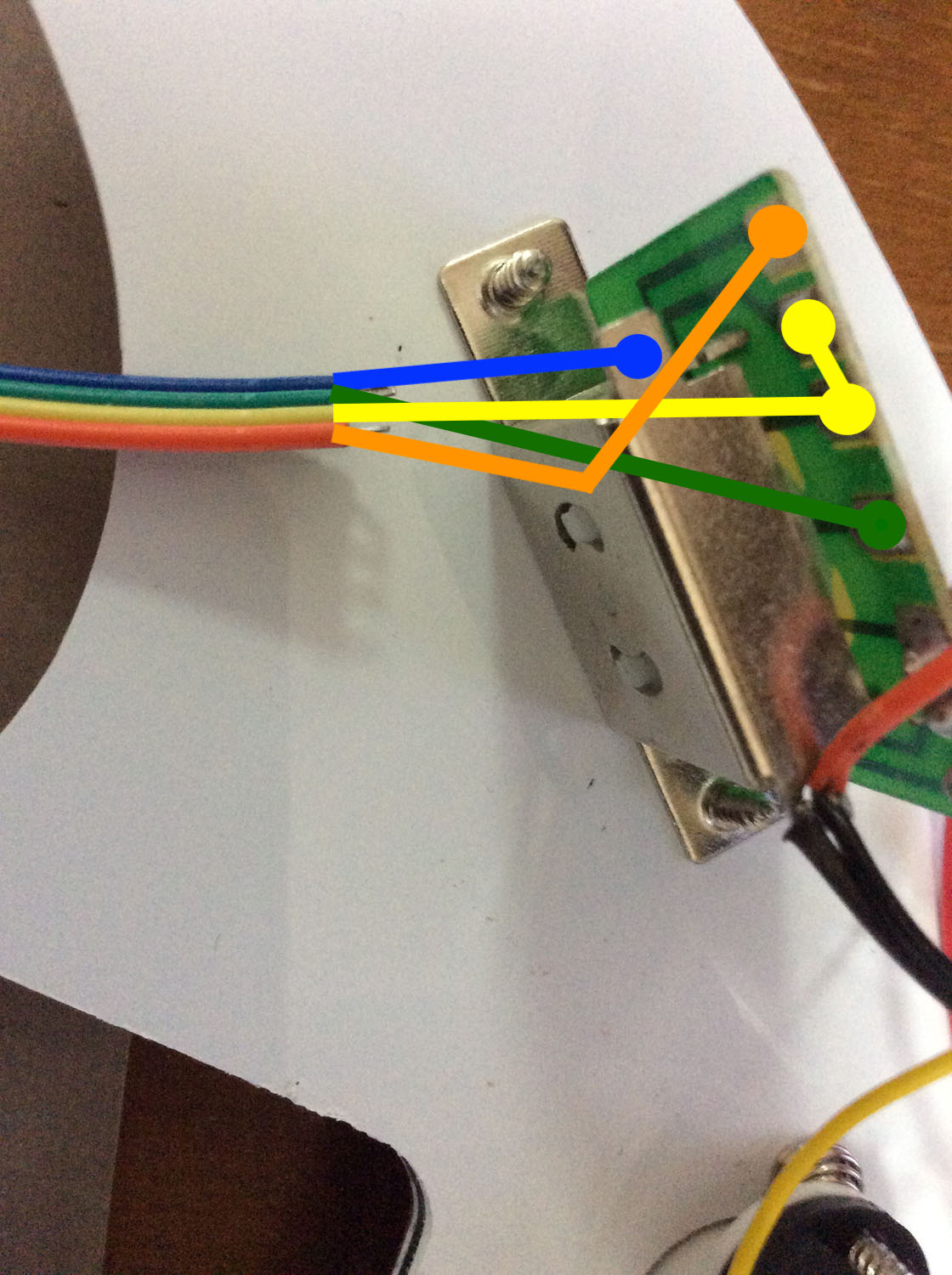

    Different batches of kits and models can have different wire colours, so it's difficult to always have an exact match with the diagrams. But you'll soon get the hang of working out what should connect where.
    First off, something didn't look quite right... labels corrected.
Name:	Z80AL_JMA6_wiring 3 - annotated.jpg
    General layout:
Name:	Z80AL_JMA6_wiring 2 - annotated.jpg
    Switch connection options
    Standard strat style: Neck = Tone 1, Middle = Tone 2
    (no tone control on bridge)
Name:	Z80AL_JMA6_wiring 1 - standard_strat.jpg
    Bridge Tone style: Neck = Tone 1, Bridge = Tone 2
    (no tone control on middle)
Name:	Z80AL_JMA6_wiring 1 - B-N.jpg
    Bridge & Neck-Middle Tone style: Neck & Middle = Tone 1, Bridge = Tone 2
    (tone 1 will also affect bridge in position 2)
Name:	Z80AL_JMA6_wiring 1 - B_MN.jpg
    Pick the option that suits you best.
    Make sense?
